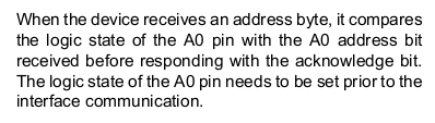

From the datasheet:
afbeelding
That is not 100% clear.
It might be possible to connect all the MCP4725 to the Arduino Uno and have an Arduino output pin for each A0 of the MCP4725 and set them all high.
If a MCP4725 is selected, that A0 pin can be set low and then it can be used. When the Arduino is ready with that specific MCP4725, then the A0 pin is set high again.
It takes 9 digital pins, but you don't need to buy more hardware.

Correct. You have to address each one and set its output voltage independently. That might take around 100 microseconds per device, or all nine in less than 1 ms.
Do not be confused by the "analog pins" A4 and A5, they are used as digital pins in the I2C application, and have nothing to do with analog signals.
I'll ask more directly - are you using the Adafruit product? You can do as Koepel suggests, setting one device's A0 high and the rest low, or vice-versa, then communicating with each item, but it will require more software overhead, and you'll have to manage all that yourself. Doing it that way, though, you do have the advantage of implementing anywhere from 0-n devices, where n is the number of digital signals available to select the boards. You could even go as far as to use an external logic selector, such as a 74ls138, to select one-of-n boards, consuming fewer digital pins. It's up to you, and likely dependent on application details you've probably not told us.
