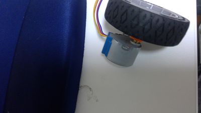

Hi I am using a Arduino Mega a small reduce speed stepper motor(very slow and limited speed of 15), and a stepper motor driver(picture shown below).I want to write code for 2 stepper motors moving at the same time. I've searched everywhere for it but cannot find it. The code shown below is a version that doesn't work. I was wondering if there is another way to do it.

If you want to move two stepper motors at the same time with the Stepper library then you must move each of them one step at a time and use your own code to deal with the intervals between steps.
If the movement of the two motors does NOT need to be coordinated then you could use the AccelStepper library.
If you need coordinated motion (meaning that stepperA needs to go 156 steps in the exact same time as stepperB does 403 steps) then you can use the MultiStepper version of the AccelStepper library. But note that it does not do acceleration.
If you need coordination with acceleration it is not all that difficult to write your own code.

The stepper motors I am using: 28byj-48 geared step motors
