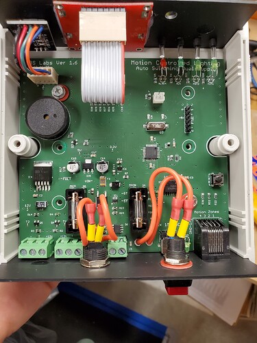

It's not an Arduino its an embedded Mega328P (32 pin TQFP) in a custom circuit and board I designed. The system works well however the Nokia LCD will, given enough time sitting idle, get slightly scrambled. I believe its losing the clock edge or something and getting out of sync. It takes a while but the system sits and looks for PIR signals for months and only needs the screen for system setup.
 ![20220227_124313](https://europe1.discourse-cdn.com/arduino/original/4X/a/4/c/a4cefd61df2746bae8bc77c0e4219b9fa2c8d510.jpeg)
