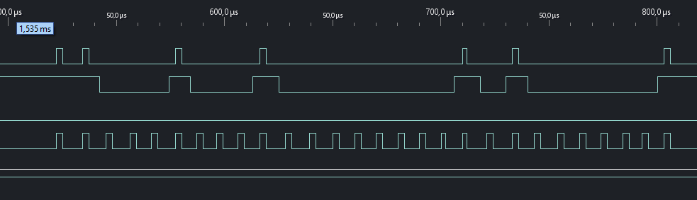

I borrowed a Bus Pirate v3 and used it to capture the output of my Arduino, it looks legit:
This productes:
1 | 1 0 0 0 1 0 0 0 | 1 | 0 0 0 0 0 0 0 0 | 1 | 0 1 0 0 0 0 0 0 | 1
Exactly as needed to set Lch volume to 0.0 dB by the datasheet.
So I run this code on the Arduino connected to the IC aaaaand - nothing happens. I connected AC meter to the speaker output and touched the input terminals with my hands. It's a 140 W amplifier so it should generate a lot of AC voltage when touching inputs. But nothing, zero. When I touch inputs directly to power amp, after this IC, I get some small voltage. I confirmed that months ago when I connected the actual speaker and a very quiet "brum" could be heard on touching those inputs.
Do you see anything wrong with my code or this just won't work and I should give up?
Please label the traces in that timing diagram.
If the bus is I2C or I2C-like, then the data / clock lines must be open collector with pullup resistors. Instead you're pulling them hard either HIGH or LOW. That could mess things up if the slave is trying to ACK. There is some code out there for bit banging I2C on an AVR. As I recall, it uses direct port manipulation to switch the pin between OUTPUT (to drive it low) and INPUT (to drive it to HIGH-Z). Maybe search around for that example.
