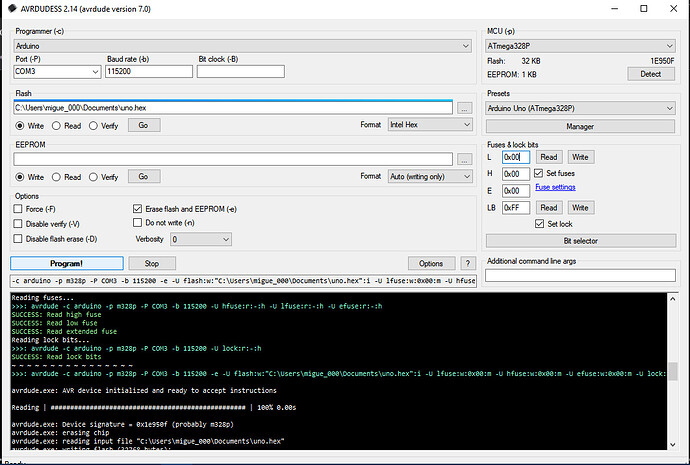

Well finally i can access to binaries into chip, im trying to read hex and i can, also write and i can because the lock bit is 0x00 but i cant modify the lock bit from 0x00 to 0xCC to protect the code, i presume that i must erase the chip then i can modify the lock bit from 0x00 to 0xCC but how i can erase the Atmega328p placed in Arduino Uno?

I tried to erase it with a blank code and can write it but dont work to reset lock bit to 0xFF, the chip is blank but the lock bit remain as 0x00.

You perform chip erase operation and then read the lock bits; they should be 0xFF.
How i can erase? i tried uploading blank code but dont work, i assume that i just write the code but dont affect to registers where are placed fuses and lock bit.
Please, post the pictures of you AVR Programmer and the AVRDUDESS Interface. These are my stuff:
Chip erase does not affect the settings of the fuse bits; they can only changed using Programmer. You may read the following Tables to know the purposes of the Fuse Bits and Lock Bits.
I use Arduino Uno as programmer via serial, it works and can read/write code and eeprom, but cant modify fuses and lock bit.

this the line that DUDES use to try.
>>>: avrdude -c arduino -p m328p -P COM3 -b 115200 -e -U flash:w:"C:\Users\migue_000\Documents\uno.hex":i -U lfuse:w:0x00:m -U hfuse:w:0x00:m -U efuse:w:0x00:m -U lock:w:0xFF:m
I know that Arduino works to read/write via DUDES because i compile the program as hex with arduino with some modification in some line text that dont affect the code, and then i write the hex to chip with DUDES and show the modification in text, so the arduino used as programmer work to read/write the flash and eeprom.
Can you make a test with arduino as programmer to test if you can modify the lock bit using Arduino as programmer?
If you can then im made some wrong.
and if you cant modify the lock bit, then Is needed an extern programmer.
Arduino as ISP programmer does not do Chip Erase operation as a seperate task. This programmer has no access to Fuse Bits and Lock Bits. You need a Universal ROM Programmer (Fig-1) or an AVR Programmer (Fig-2) to access these its. However, the RSTDISABL and SPIEN fuse bits can only be unprogrammed using Parallel ROM Programmer.
