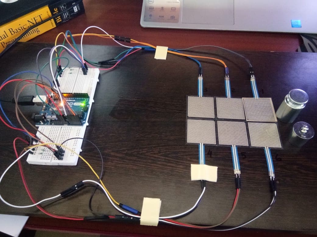

How to reduce/eliminate fluctuations in FSR sensor?
Below code for connecting 6 FSR 38.1mm Square type with Arduino UNO.

And my output 10 samples with interval for same weight in different sensor.
below is my circuit connection.
I need to reduce the fluctuations in each FSR, so that i can able to calibrate for weight calculation.
Thanks in advance.
your code has comments issues.
post the output as text, and the circuit directly here (drag and drop the image into the post)
  • ensure you perform a double read of the analog pins to let the voltage stabilize for the ADC
  for (int i = 0; i < numFSRs; i++) {
    analogRead(fsrPins[i]); // throw away
    fsrReadings[i] = analogRead(fsrPins[i]);
  • quality of your power supply is also important
What is that double read.?
my output, first is raw analog reading and next average output. it keep on increasing and when i place next the same weight of 100g it will start with different value and keeps increasing.

@sugan04
FSRs may be easy to use but they are not an accurate means to measure force. Basically when you use FSRs you should only expect to get ranges of a response, hard, medium, soft, etc. They also vary some from sensor to sensor perhaps 10% or more. So, while FSRs can detect weight, they're a bad choice for detecting exactly how many pounds of weight are on them.
My application: I need to measure force given for ultrasound scan by the doctor using Probe. @jim-p
I don't see how that would be possible because the FSR would interfer with the ultrasound transmssion/reception.
That’s to let the input of the ADC getting more stable
