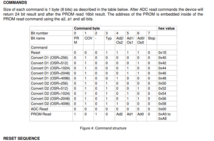

How to set best Resolution MS5611 sensor?
I can't figure how to change settings for top OSR?
According to the datasheet it must be 4096 for better precision.
I can't make this settings work.
Could anyone help?

 D1 = getData(0x48, 10);
 D2 = getData(0x50, 1);

long getData(byte command, byte del)
 long result = 0;
 twiSendCommand(0x77, command);
 delay(del);
 twiSendCommand(0x77, 0x00);
 Wire.requestFrom(0x77, 3);
 if (Wire.available() != 3) delay(8);////////Serial.println("Error: raw data not available");
 for (int i = 0; i <= 2; i++)
 result = (result << 8) | Wire.read();
 return result;
