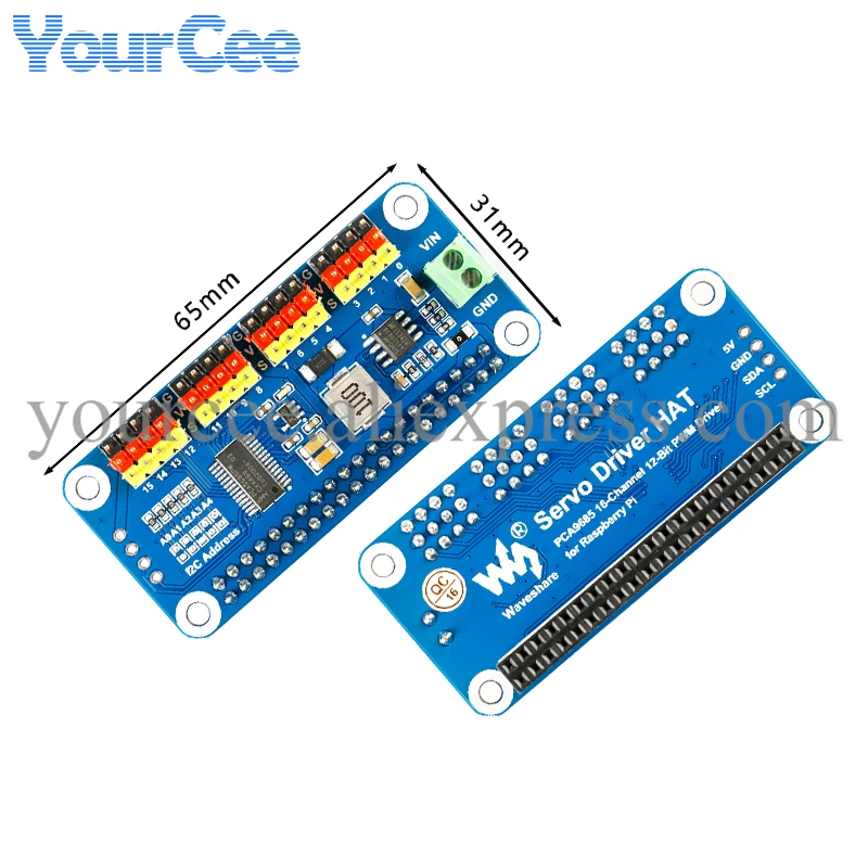

Sorry for not mentioning the other questions in the original post, but it just came on my mind, because i have the servo driver and i would like to know how to control it from it
this is the servo driver i am talking servo driver
Do you have the documentation for the driver that shows how to control it? If ot, that is where to begin, not pictures of a board.

The Adafruit version of that servo board uses the same chip. Maybe you can use the Adafruit library.
