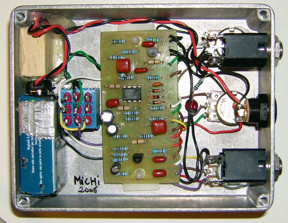

Lets start simple, how do I read the value from an analog pot so I can store different values to different buttons?
My final proyect is to place the Arduino between the outputs of the pots on a pedal and the inputs that go to the board to first save and then load different outputValues of the pots:
... but that is the final idea, now I just wan't to know how to do it on 1 pot. I think I can use this http://arduino.cc/en/Tutorial/AnalogInOutSerial but need a way to save the outputValue that goes to the LED and save it in a button so I can load it when that button gets pressed. After that make it work with different outputValues of the pot to 3 buttons. If you guys can help me on this I can be on my way to complete my project.
I know I'm asking for maybe too much help but I don't seem to find a sketch to base my project from that uses all that I need.

I have written this to read from the pot and print out the value when it is recalled.
You need two buttons, one to tell the system to store the pot value and the other to tell it to recall it.
Disclaimer:- This code compiles but I have not tested it.

However, the difficult part in your project is presenting a pot value to the output. This vitally depends on what the output is being connected to and what voltages there are on that device.
This link shows you the basics:-
So I need to use a digital pot to have the different output pot values?
How else did you think you could do it?
Grumpy_Mike:
Don't know, since I'm new at this I'm clueless on how all of this works together really! I thougth this works just like a pwm output.
Last couple of days I haven't taken time to make progress on this but I've been giving it thought, and I don't know if I have been looking at it from the wrong point of view. What I want this to do is just to store the value that's coming out of the pots on the pedal in say 3 different positions (at 25%, 60% and 100% of the pot) and use the Arduino to send that value out in to the pedals own board just like if I would have instantly change the pot manually.
