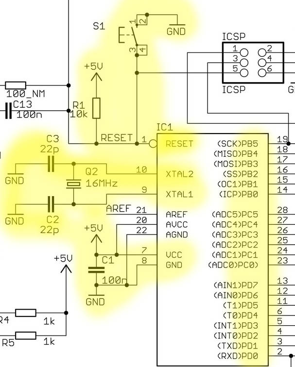

Hi Denno,
Maybe you should look at the Arduino schematic diagram. Here's an example on the ArduinoInfo.Info WIKI, but ALL the Arduino schematics are on Arduino.cc : http://arduino-info.wikispaces.com/file/view/arduino-duemilanove-schematic.jpg
What You Need as a minimum (IF you program the 328 chip on an Arduino board):
  • Stable +5V power supply, with close-to-chip bypass capacitors
  • Oscillator components: Crystal, Resistor, capacitors
  • Reset circuitry for power-on and manual Reset
  • Connections to your actual application external circuits based on the 328 pinout
So this part of the schematic:
Let us know how you make out....
Thank you terryking228, I think I understand that a little better now..
You say a stable 5V source.. I'm kinda afraid to ask, but what are batteries considered? Most likely unstable as they loose voltage as they discharge right? Could I fix that with a voltage regulator, and use a combination of batteries that give a higher voltage than 5V?
I can't see where the resistor goes in the part about the oscillator in the diagram?
Oh.. Hmmmm. The UNO schematic shows a 1 meg ohm resistor across the crystal:
http://arduino.cc/en/uploads/Main/Arduino_Uno_Rev3-schematic.pdf
Anyone have experience with this resistor + or - ??
"Stable" - batteries are often used.. 4x NiMH gives about 4.8V and many people find this OK. But when they are running down and motors are driven by same batteries, failures occur. So: Depends on what motors you might be using.
"Real Stable" would be a voltage regulator fed by 7.2 to 9 volts, putting out 5.0V . Like the voltage regulator circuit that is adding lots of components to that Arduino board...

The resistor is not needed, it's built into the mcu, and the atmega328p-based systems I build don't have it.
Also check out the standalone Arduino.
http://www.arduino.cc/en/Main/Standalone
denno:
Where could I find exactly which crystal and capacitors I would need? Being able to program the chip whilst it’s sitting in the Uno board, and then just taking it out after that would be the most simple way I would think, at least until I get a better understanding of how the circuitry works.
Unless you need good frequency accuracy (which you don’t, because you are using a RTC) then the simplest solution is to use a 8MHz or 16MHz 3-terminal ceramic resonator, which replaces the crystal and the caps.
denno:
What would I need a reset button for? Would that be as simple as adding a push button to pin 1 of the chip?
You don’t need a reset button, you can reset the chip if you need to by disconnecting and reconnecting the power.
I recommend including a 6-pin ICSP header in your design, so that you can program the chip in-situ. See http://miscsolutions.wordpress.com/2011/08/09/prototyping-small-embedded-projects-with-arduino/ for more.
