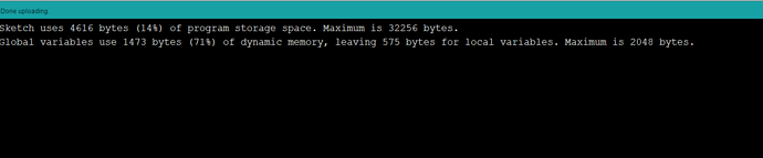

Hello. I am new to arduino and RGBW LED strip. I am using SK6812 RGBW LED Strip.
This post helped me in filling the LED strip with single color.
However, I want to make the LED strip glow once the buttion from C# form is clicked. I have used serial Port and when the char '1' is sent, the led strip is to glow. But, the code is not working.
The Arduino code is as follows:

How do I turn on the LED strip using C# WinForm Button
P.S.: In the simple RGB LED strip, the Code in C# works. It is not working in this RGBW Strip.

What do you see if you print the value of incomingOption ?
Where, In arduino or C#?
On the Arduino. After all, that is where you test its value and if it is not what you think then the test will never return true
I am not quite sure, where should I print it?
I added ** Serial.print(incomingOption);** as in the following code snippet, but it did not print anything.
switch (incomingOption){
    case '1':
    colorFill(CRGB::Red);
Print it immediately before the switch() that uses it, not in a case where it has already been tested
It is printing nothing.
Do you thinks that it might work better if you had Serial.begin() in setup() ?

  1. As indicated in post #9 by @UKHeliBob , you're still missing a Serial.begin() in setup(); did you ever test this with serial monitor.
  2. You should check if serial data is available before reading it.
  3. Your code is unresponsive; it takes ages once you have send a dgit before it reacts to another digit. This is due to your 300x50 ms delay. I suggest that you rewrite it in a non-blocking way.
Please fix at least (1) and (2) and preferably (3) and post a new version of the sketch [edit]if you still have problems[/edit].
I don't immediately see something wrong with the C# code but haven't tested it.
Since, I am new in arduino, I have not tested these all. I will try to test them all. Thank You.
I solved this problem. Thank you everyone for your help.
