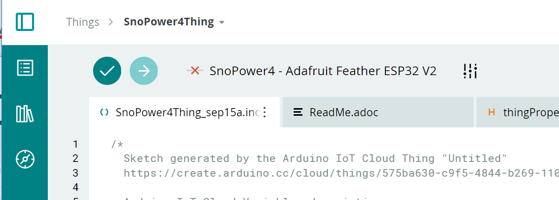

How to use Adafruit Feather ESP32 V2 with IoT Cloud?
I have created the Device, Thing , and Sketch but Arduino cloud doesn't find the Feather ESP32 V2 on a USB port to download. Device Manager in Windows 10 finds the device on COM4. Using the standalone IDE rev 2.3.2 I can download fine. But IoT Cloud doesn't find the board.

Due to an inappropriate configuration in the 3rd party ESP32 boards platform, it is not possible to upload to this board (or any board other than the "LilyGo T-Display" that has the WCH CH9102 USB to serial bridge chip) via the serial port when using Arduino Cloud.
I recommend using Arduino IDE to develop sketches for this particular board.
Note that, although it will be most convenient to use the Arduino Cloud web interface for the initial setup of the Arduino Cloud Thing, after that you can use Arduino IDE for all further development and serial port uploading of the sketch. You will see newly created Thing sketches under the "Cloud Sketchbook" tab of the IDE's "SKETCHBOOK" panel after you click the "Sync" icon at the bottom right corner of the panel.
