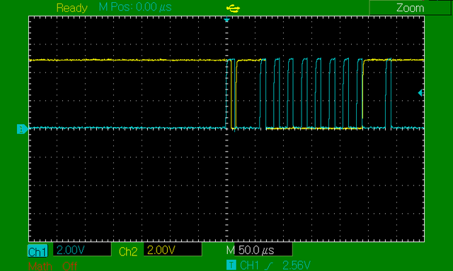

I'm trying to program a Siemens SDA3302-5 chip with an Attiny85 via I2C.
But the data coming out of the I2C Bus doesn't look like expected and the 3302 chip does not do what is should.... Does anybody have an idea?
This is what I have so far:

The only signal I see is:
https://i.ibb.co/c3W61WJ/MAP001.png
Does anybody know if this is possible?

The I2C address is a 7bit value, try B01100000 as the value of I2C_ADDR (as you failed to post a wiring diagram I simply assume you connected CAS to GND).

I found the wiring diagram. I would like to swap the PIC (button left) with the Attiny85 as an I2C programmer for the SDA3302-5 chip.
That means you didn't copy/paste the code. What else might be different between what you actually used and what you posted? Don't waste out time, post exactly that code that you use for testing!
If you actually use that wiring the I2C access is either 0x63 or 0x62 depending on the status of jumper 1.
I would not use R29 and R30 but use external pull-ups instead.

PS: I was copying the code, but accidentely grabbed a version I was testing with. I wanted to see if there is anything changing on the oscilloscope when changing the address.
