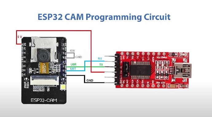

I've tried as you suggested. the port that appears is port com9. so I tried to upload using that port. but this problem appears
A fatal error occurred: Failed to connect to ESP32: No serial data received.
as for the circuit that I use like this
Try a different GND pin connection on the ESP32CAM.
On some more recent ESP32CAMs the pin next to UOT is connected to Enable\Reset.
I see, it looks like my esp32 cam has a problem. only 1 GND pin is working properly.
Not sure what you mean by that.
What is the label on the pin next to UOT ?
It is much easier to use the esp32-mb board. Also, when showing error log we need to see all of it.
