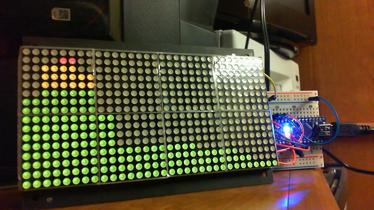

Hello,
I am working with MAX7219 8x8 single-color matrix. Ofcourse I am using LedControl.h library. And I got one little issue: I saw one guy on the internet doing the same project, but with bi-color 8x8 led matrix... So he is using ht1632.h library(it's almost the same like mine). And I can't find an appropriate guide how ht1632 library is working?
So I got some code lines from ht1632 project:
dotmatrix.line(4, 15, 8, 7, GREEN); // I don't understand what those digits in brackets mean

This is the prototype for the 'line()' function:-void line(int x0, int y0, int x1, int y1, byte color);So my guess would be that x0, y0 are the co-ordinates of the beginning of the line, and x1, y1 are the co-ordinates of the end of the line. ('color' is the colour of the line. :smiley: )
This is 'plot()':-void ht1632c::plot (byte x, byte y, byte color);It's probably safe to assume that this will light an individual LED, with x and y being the co-ordinates.
