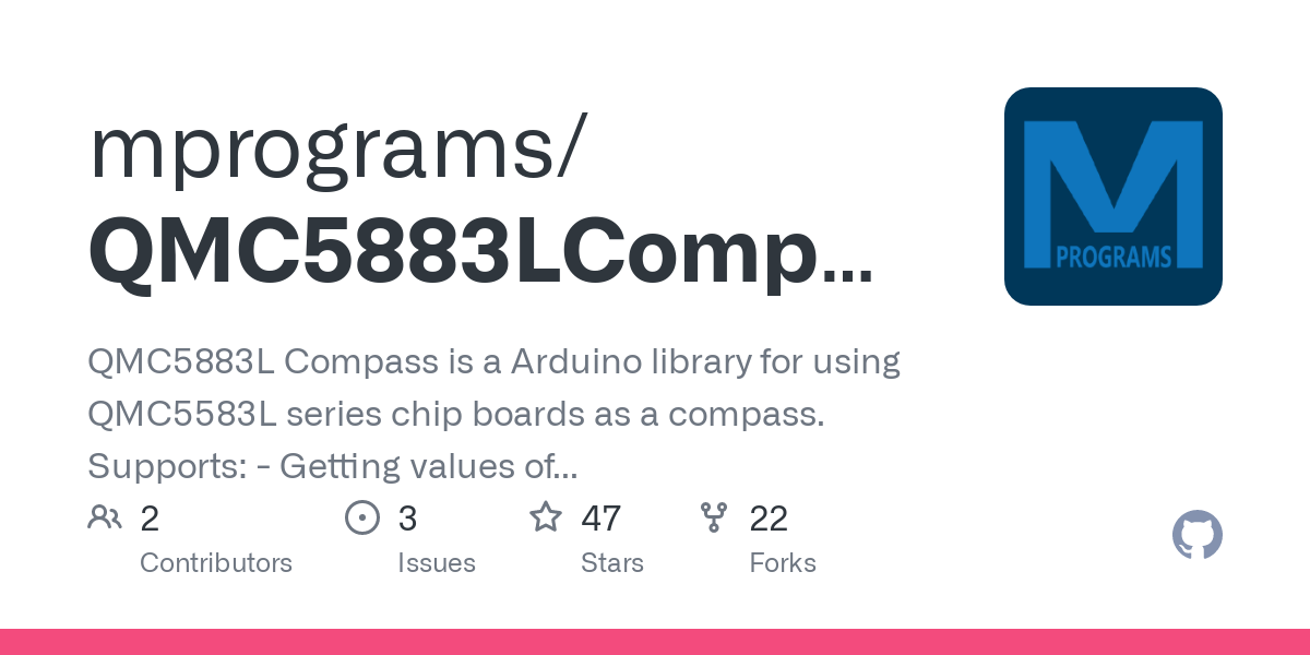

@newtechai Do you have a link to your QMC5883L library?
Is it this one?:
yes it is it
