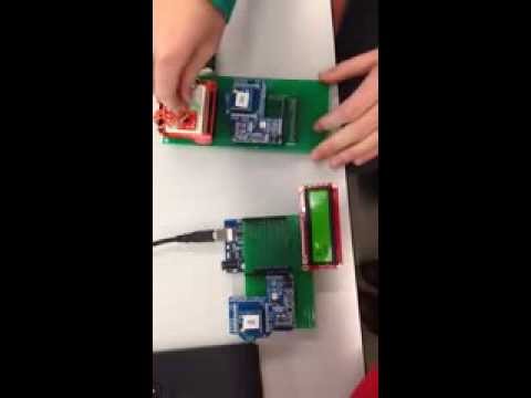

Here Is what I want to copy, with the dryer switch.
Did you see the title of the video? Working in the lab and tumbling around in the heat and the humidity in the drier and a world apart.
Edit: On the other hand, nothing happened in the video, so I expect that you WILL be able to replicate that.
Here the same utub movie and it's working.
