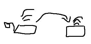

Okay so i have a sensor, arduino, and ESP8266 on one side and i need to send the sensor's info to another arduino with a esp8266. The question is how do i begin to do that. I just got these two esp8266 chips and have zero knowledge of networking or this chips libraries. Thanks in advance.
I added a drawing just incase it doesnt make sense.:slight_smile:

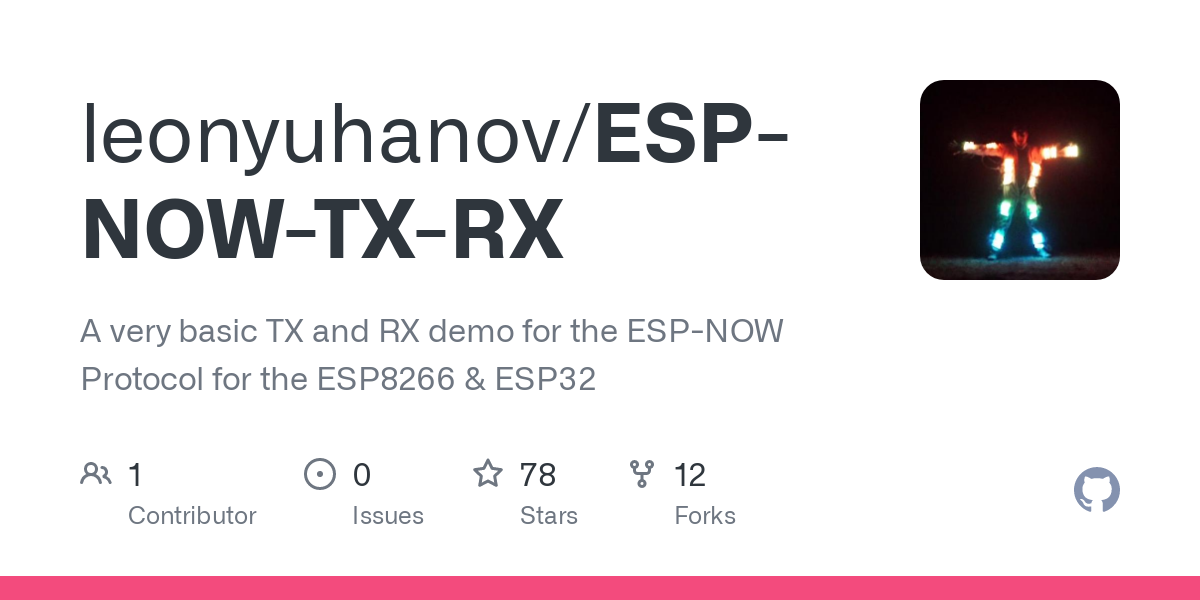

Have a look at this:
There are examples for the ESP8266, but I am using the examples as basis for exchanging data between two ESP32.
Cannot help with the ESP8266 as I have not tested the examples for this.
