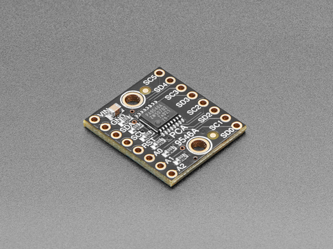

If you can find one, the TCS34721 is the same sensor with an I2C address of 0x39 instead of 0x29, but even the data sheet says to contact the manufacturer for availability.
An I2C multiplexer would do the trick.
For whatever reason that is not acceptable.
No, but some Arduinos have more than one I2C bus, and there is always software I2C, which works on any pins. That sensor is not at all demanding of speed and bus capacity.
