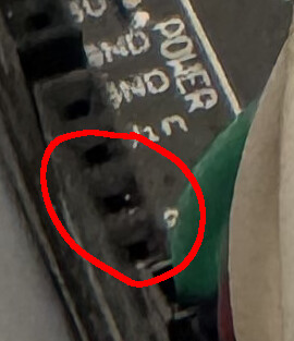

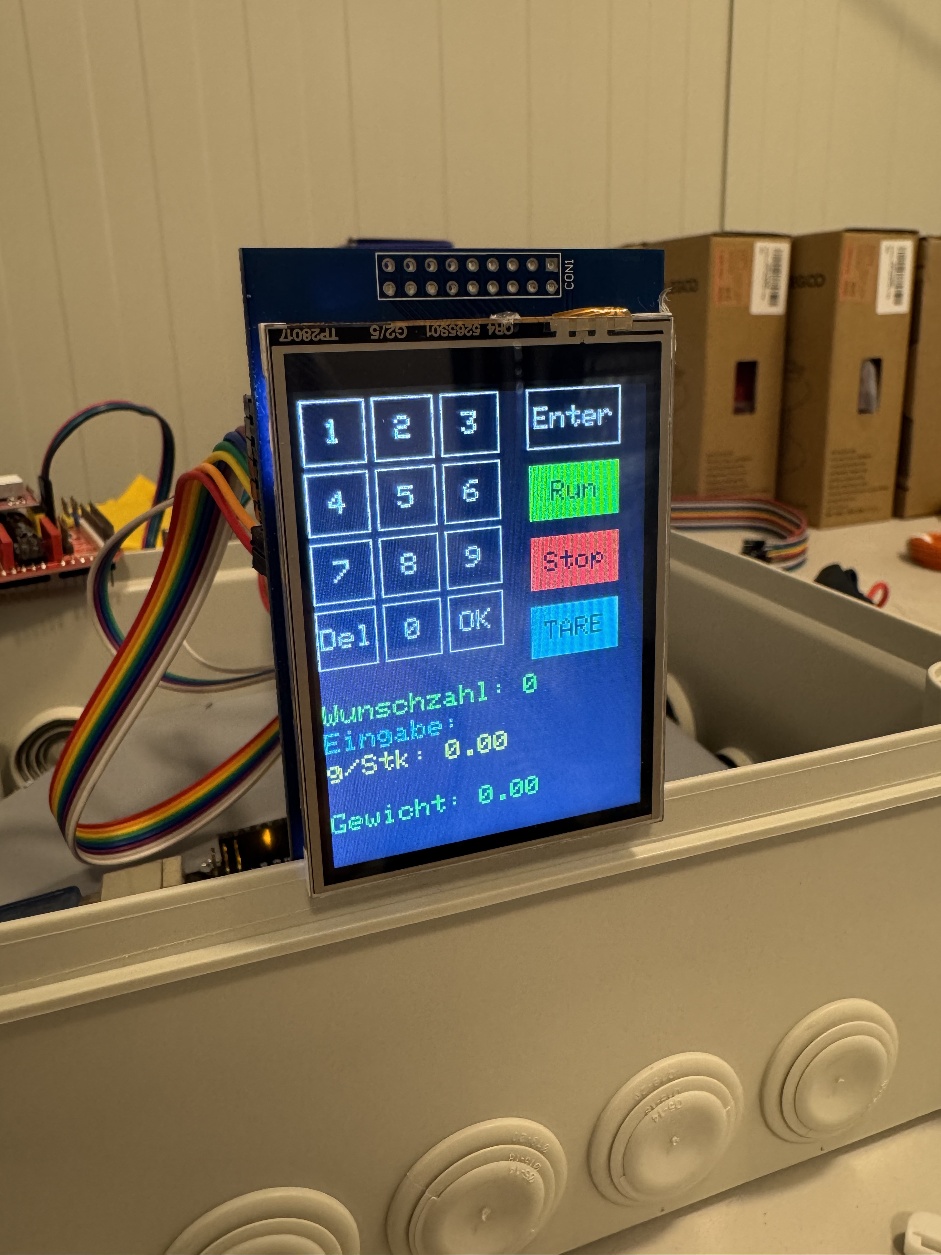

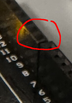

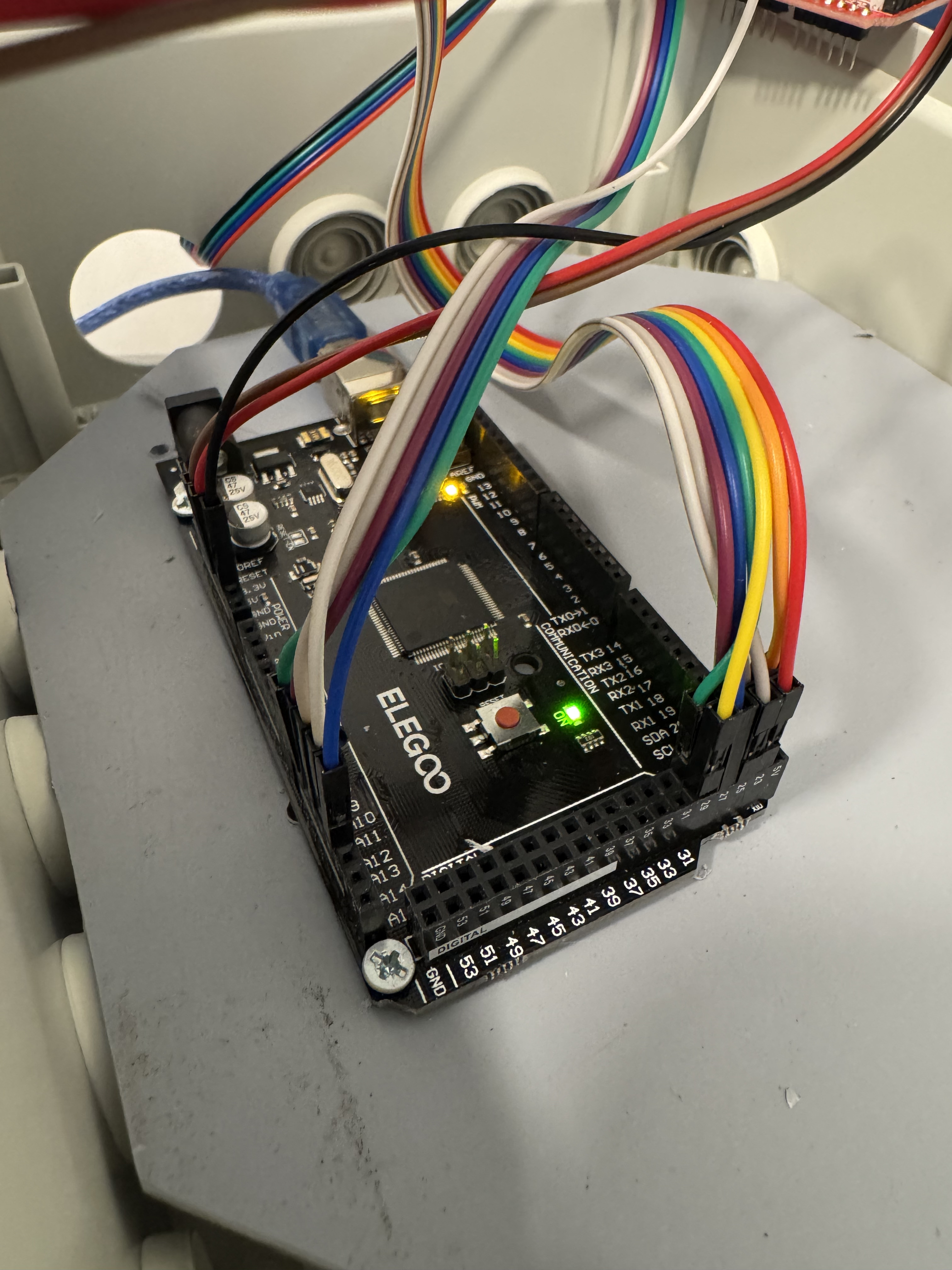

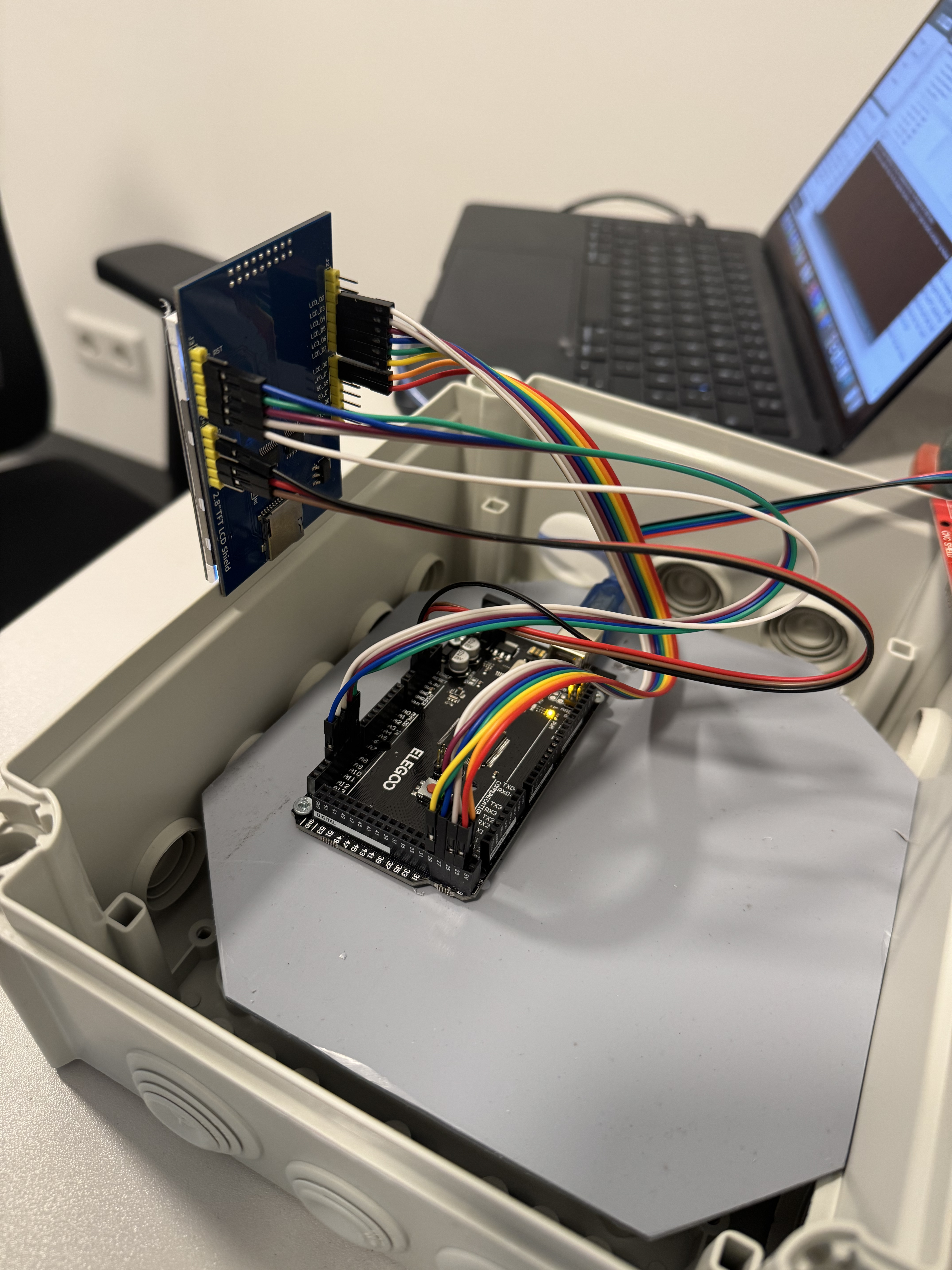

Hi all, I am currently building a scale with two stepper motors. Right now I am only trying to get the display and touch controls working, but I am struggling a lot today. I have a CNC shield on a Arduino Mega and I use the ELEGOO 2.8" Touch Screen but using ribbon cables. That's because I cannot attach two Shields on one Arduino.
The following code is working and the display shows some buttons and text. However, the touch input does not work yet. That's what I ask for your help with. I managed to find the right library and pinout, otherwise the displays would not be working. I asked ChatGPT a bunch for advise, but it is pretty useless with this. It keeps telling me to connect physical touch pins, but they don´t exist on my TFT. This Adafruit article gives some insights on those pins, but I don't get it. [Touchscreen Paint Example | 2.8" TFT Touch Shield | Adafruit Learning System](https://learn.adafruit.com/2-8-tft-touch-shield/touchscreen-paint-example)
Anyway the touchscreen worked, but only when it was connected as a shield. Not with ribbon cables. Any ideas what I am doing wrong?
 ![IMG_7053.HEIC](https://europe1.discourse-cdn.com/arduino/original/4X/4/b/8/4b8ad98b17c4b769e417e45a0878872e3def8d9a.jpeg)
 ![IMG_7052.HEIC](https://europe1.discourse-cdn.com/arduino/original/4X/7/c/a/7cabb3d7a9fc681ae854a754bd42a1b2262b39e9.jpeg)
 ![IMG_7051.HEIC](https://europe1.discourse-cdn.com/arduino/original/4X/3/5/7/357766e9c1701d27d36cfd8d4f3cd713a39a4b5b.jpeg)
 ![IMG_7050.HEIC](https://europe1.discourse-cdn.com/arduino/original/4X/9/7/4/974cea1d1acf9ce17108ed86848b2cca509ff259.jpeg)

> [@MaxMaker](#):
- 1st confirm the continuity of each ribbon cable wire.

I spent 6 hours troubleshooting. I even checked continuity on those tiny access tabs on the connectors.

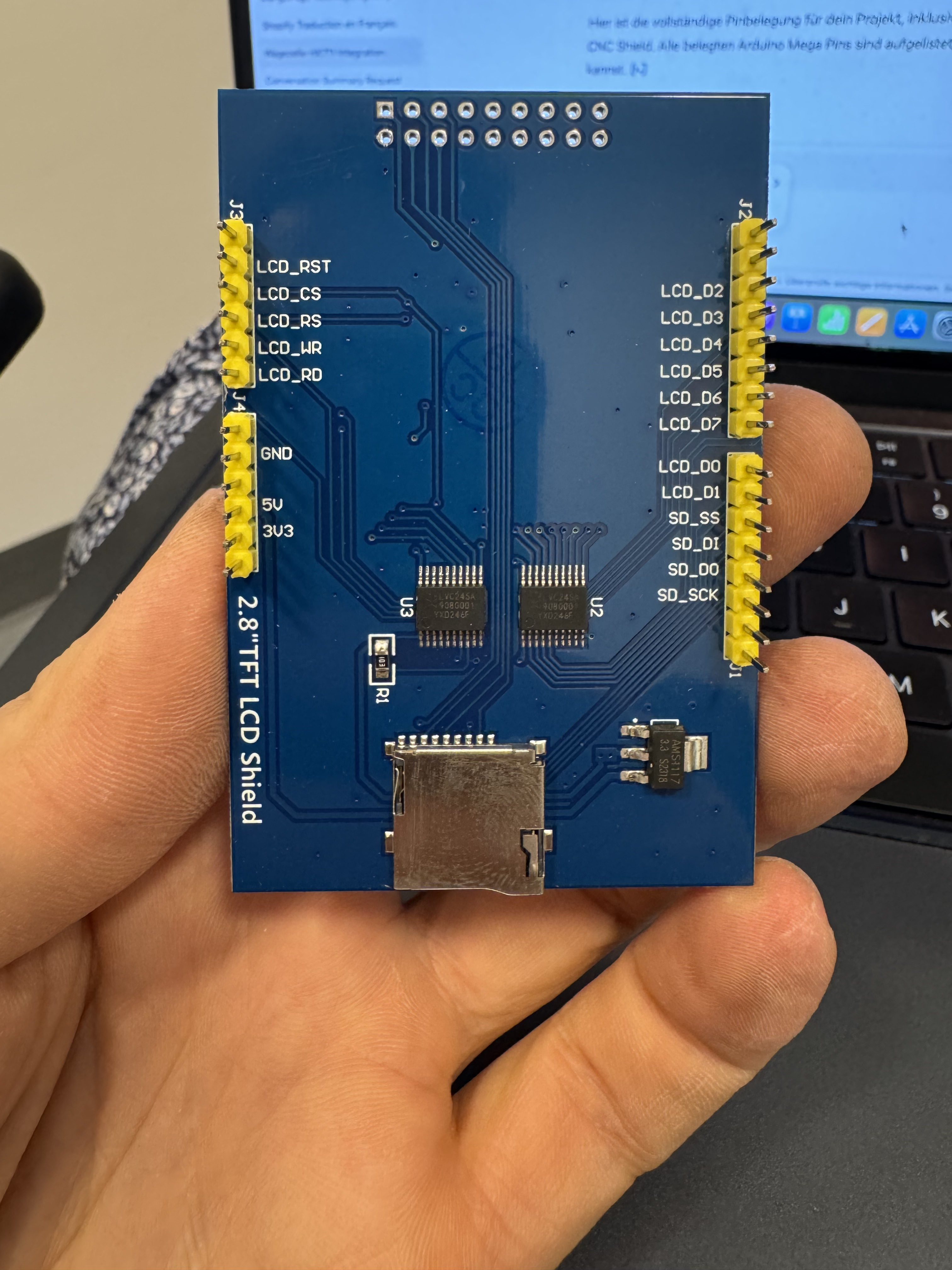

If you have the touchscreen pins correct for using the display as a shield:
```arduino
#define YP A2 // must be analog pin
#define XM A3 // must be analog pin
#define YM 9 // can be digital pin
#define XP 8 // can be digital pin
Then they should be wired as follows. I'm not sure which pins you are using for the LCD data lines, and you appear to be calling LCD\_RS by another name. The pins are shared with the display, which is why YP and XM have to be set back to output mode immediately after calling the ts.getPoint() function. (although you seem to be setting XP to output mode instead of XM, it should be whichever pins of the touchscreen are connected to LCD\_RS and LCD\_CS).
```arduino
YP = same as LCD_RS
XM = same as LCD_CS
YM = same as LCD_D1
XP = same as LCD_D0
\< edit \> Oops, had YM and XP wrong, had trouble matching the picture to a UNO pinout.

> [@LarryD](#):
The touch screen shares pins with the TFT display, if the display is working then the wiring is OK.

You have no connection to any of the touchscreen pins that you have defined. That's why the touchscreen doesn't work.
As @david_2018 has already pointed out, the touchscreen pins on the shield are shared between the display and the touchscreen and do double duty. You will have to redefine the touchscreen pins to be whatever you've moved the corresponding display pin to. And LCD\_RS (YP) and LCD\_CS (XM) must be on analog pins.

I am using A8-A12 instead of A1-A5. Thank you for your explanations. How am I supposed to know which pin is X and Y? I read the tutorials and manual many times. I never found that information.
<div class="post-metadata">
**Author:** ![david\_2018](https://dub1.discourse-cdn.com/arduino/user_avatar/forum.arduino.cc/david_2018/32/1013044_2.png) [@david\_2018](https://forum.arduino.cc/u/david_2018)\
**Post date:** [June 30, 2025, 10:02am UTC](https://forum.arduino.cc/t/how-to-wire-2-8-tft-display-to-arduino-using-custom-pins/1392567/9 "2025-06-30T10:02:36Z")
</div>
I though you said the touchscreen worked when it was connected as a shield. If it was working at that time, then you can tell by the sketch which pins were being used for the touchscreen.
