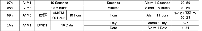

You can't set an alarm to trigger every 48 hours, but you can set it to trigger when the time and day of the week matches. As per the last row in table below (from the DS3231 Datasheet)...
The easiest way to trigger every 48 hours, is after the alarm triggers, set the next alarm by triggering 2 days later. That is, set the "Alarm 1 Day" setting to today's value + 2 (max 7).
I guess the other option is to just have an alarm every 24 hours, but ignore every 2nd alarm. You would need to keep track of the alarm count, and ensure this persisted if you lost power (for example by using the EEPROM).
