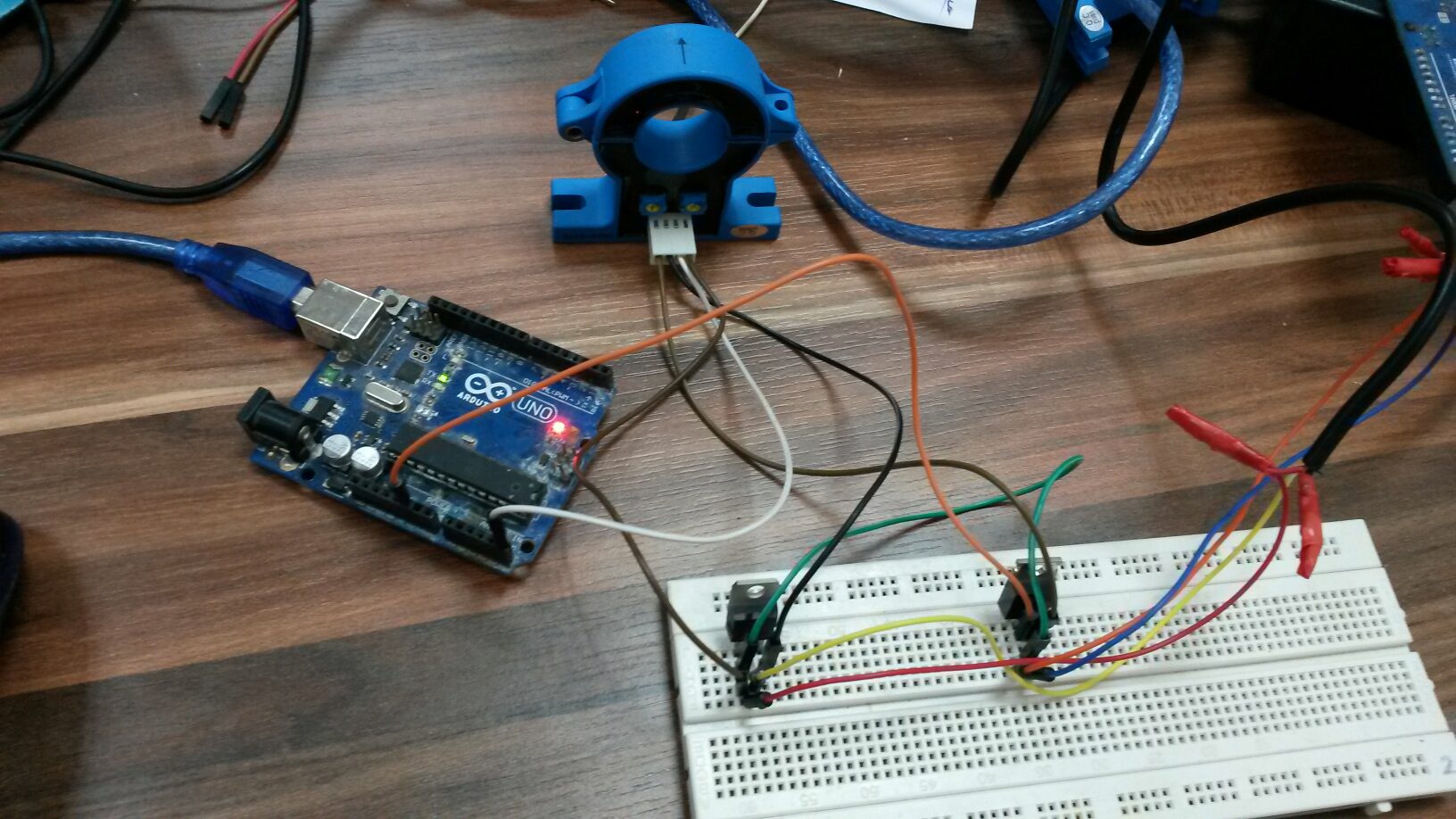

I have selected the HST21 to measure DC current, But I couldn't get the correct value to measured current.
Is there anyone has used it before, so can he help me, Please?
As in attached figure>>>
HST21 has 4 Pins (+15,-15,0V,Vout).
Thanks for all..
So how are you wiring it up the the Arduino?
What software are you running?
When you say the reading is wrong, what is it and what do you expect?
So post your code, your schematic and results.
I'm wiring it up with Arduino.
I have no problem with programming.
I think my problem is in HST21 Pins connection or something with HST21

Yes but you are not giving me anything to go on.
You have done something wrong otherwise it would work. But unless you say what you have done then no one stands a chance of spotting what it is. Sure we can guess, my guess is that it is wired up wrong and you don't have a 15V split supply, but it is a guess.
Also it would be good to have a link to that current sensor, or even a part number as that picture you posted is not so informative.

How have you wired this up to the Arduino and the power supply? Please post a schematic.

![](http://C:\Users\me\Desktop\The Circuit.jpg)

I have asked many times for a schematic, eventually you send a photograph, which is no fu**ing use because it has totally unidentified bits in it and you can't see where all the wires go. What is wrong with you?
So let me say this:-
The HST21 needs a 15 volt split supply, that means +15V ground -15V.
The HSTS21 can operate on just a single 5V supply line.
Which do you have a HST21 or a HSTS21? Have you connected it up to the right power supply for the device you have.
When you do eventually get the right power to your device you will only get a reading of 1 for a current of 58mA. Normally an analogue read has 1 bit of noise so this sensor is useless for measuring anything under 200mA.
