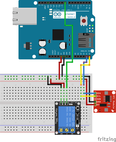

I'm using a UNO board, a HanRun HR911105A and a TinyRTC I2C Module
If anyone can help me, I'm glad!

I have an RTC to activate a relay.
I need a textbox to select a hour value and other to minutes and store it in an int, but I'm stuck on this...
My wiring diagram:
So you are trying to use an HTML page (with dropdowns).. to set the time on the RTC?
Is that the heart of this project? I'm not clear.
You have:
UNO
RTC
Ethernet shield...
is this correct?
I can see the problem...
You have two very simple code examples that probably work by themselves, however what you’re looking for is one fairly complex sketch to do something completely different.
Step one, forget the RTC, develop a web page sketch that creates a single drop-down control, then learn how to populate and process that.
Step two, extend that so you have multiple drop downs for all the variables you need.... day,month, year, hour, minute, second etc.
Once you have those working (no RTC),....
Step three, push those variables in to ‘set’ the rtc,
You may like to use the current rtc vale’s to initialise the dropdown in step one.
This set of tasks will take a capable beginner a couple of days of concentrated work, but you’ll learn a lot.
