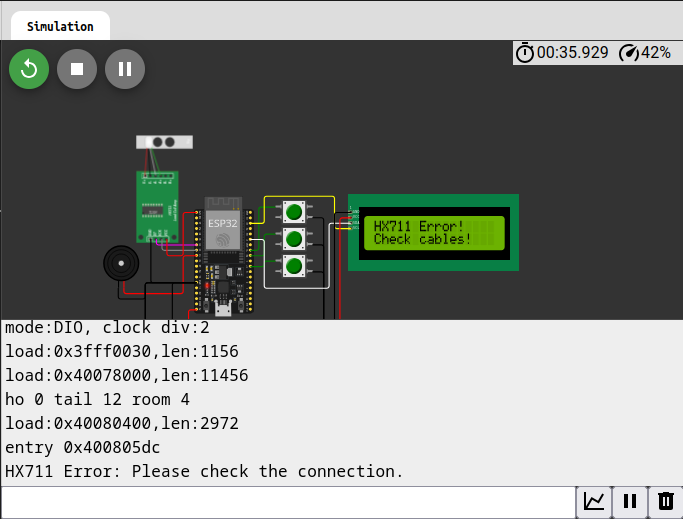

Hx711 scale program and added a cable check error
I made an hx711 scale program and added a cable check but this code always gives the words "HX711 Error: Please check the connection." When I tested it on the device, the reading was immediately unstable, there was no load, the numbers immediately went up
WOKWI TEST

Show your circuit wiring. Are the devices connected correctly? Also check the power for the circuit - correct voltage? enough current?
I use the Rob Tillard HX711 library, it works.
Are you using the simulator with a noiseless sensor?
LoadCell.start() tares the device to 0. LoadCellUpdate()'s return value is the reading, which, if still 0, will match on the if (!LoadCell.update()) test. oops.
update() is a one-shot test, and if it triggered on the last check, it started a new conversion and won't be ready for a new update yet.
I've tested it and the cable works fine but when this sign! I delete the if (!LoadCell.update()) it's normal
I already know my code. When the cable is unplugged or plugged in it still gives a cable error message
You are saying nothing is wrong with your code or your wiring? Fixed?
Did you swap 32 and 33?
I just looked at the library and it turns out that what is called to check is not !LoadCell.update()
  LoadCell.begin();
  unsigned long stabilizingtime = 2000;
  boolean _tare = true;
  LoadCell.start(stabilizingtime, _tare);
  if (LoadCell.getTareTimeoutFlag()) {
    lcd.clear();
    lcd.print("HX711 ERROR");
    Serial.println("Timeout, check MCU>HX711 wiring");
  else {
    LoadCell.setCalFactor(calibrationValue);
    lcd.clear();
    lcd.print("Startup Complete");
  while (!LoadCell.update());
