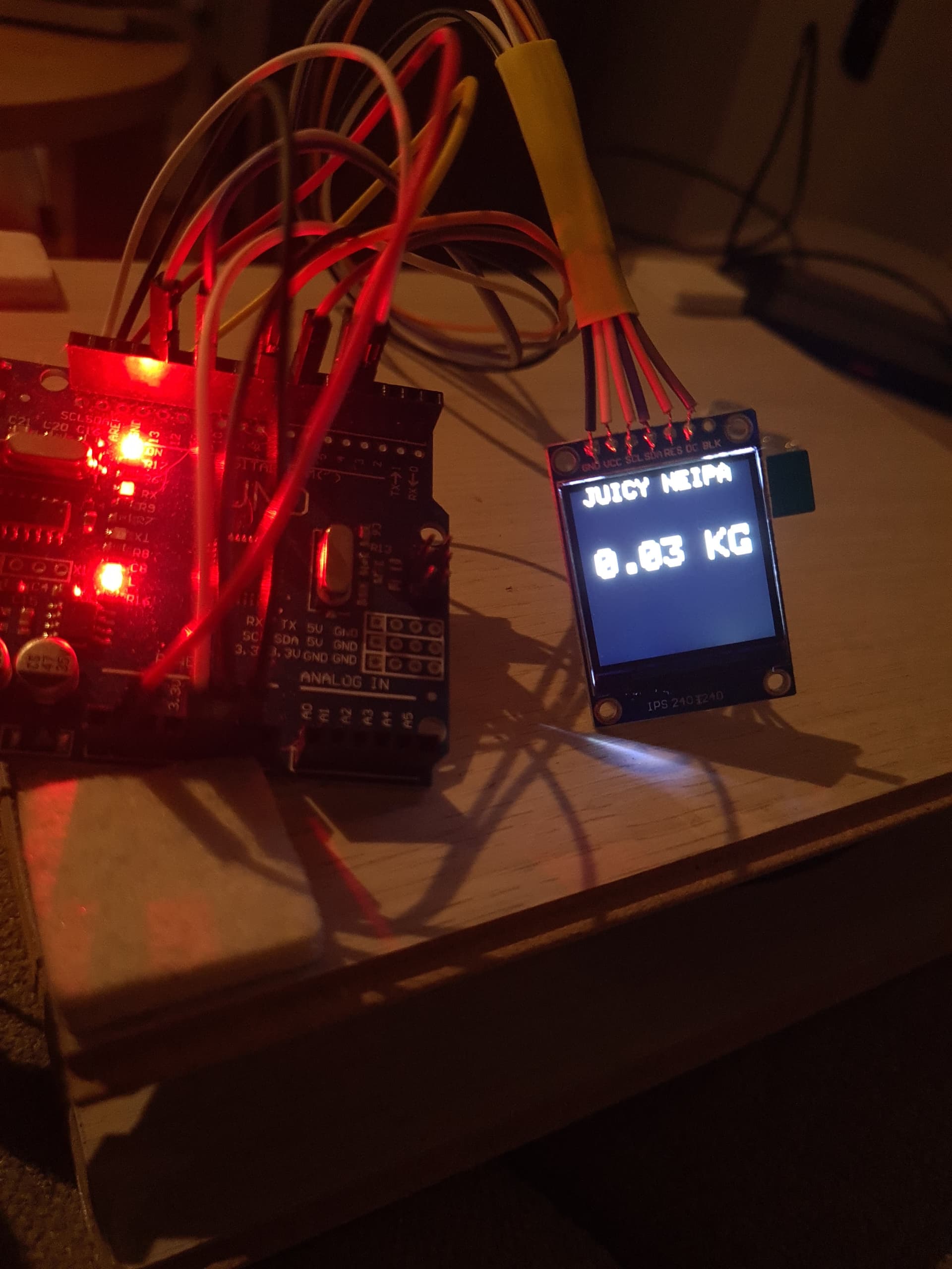

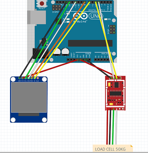

This is the setup:
Would appriciate all tips, and let me know if the post is missing any important information :slight_smile:
So in summary, i want these values to be read to a Adafruit 1.3" 240x240 screen:
Have you tried some examples in the library for that display to see how it works ?
You might also be better looking at hx711 examples too , then combining /writing your own sketch to include both parts rather than trying to alter some existing sketch .

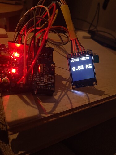

Forgot to update, but solved this with some help from a friend :slight_smile:
Final code:
