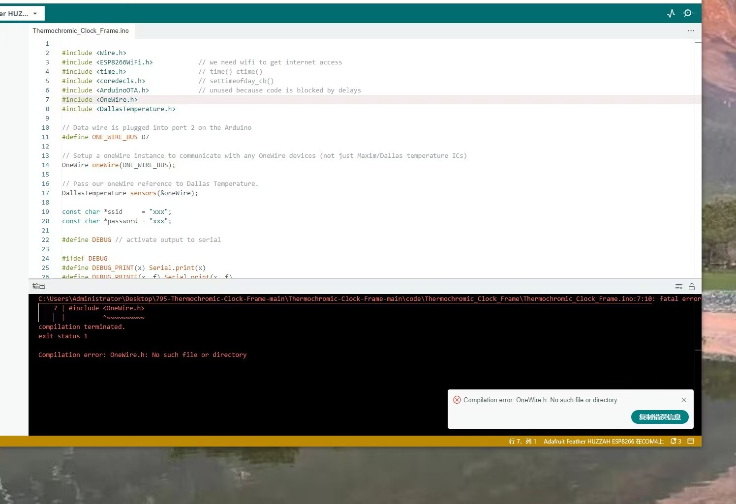

C:\Users\Administrator\Desktop\795-Thermochromic-Clock-Frame-main\Thermochromic-Clock-Frame-main\code\Thermochromic\_Clock\_Frame\Thermochromic\_Clock\_Frame.ino:7:10: fatal error: OneWire.h: No such file or directory
7 | #include \<OneWire.h\>
compilation terminated.
exit status 1
Compilation error: OneWire.h: No such file or directory
 ![IMG_8861](https://europe1.discourse-cdn.com/arduino/original/4X/0/c/2/0c265da2185673d8c7cf2edbbe6ca9ec859d34f2.jpeg)

Welcome to the party.
You’ll get better responses without screenshots (unless nothing else will do!)
Did you ‘install’ the library ?
Have a browse through the sticky posts of the forum, they’ll often give you clues on solving your question, or posting better questions !
Good luck.

> [@elaineddie](#):
You need to install that library. You can search for it and install it directly through your Integrated Development Environment (IDE).
<div class="post-metadata">
**Author:** ![Grumpy\_Mike](https://dub1.discourse-cdn.com/arduino/user_avatar/forum.arduino.cc/grumpy_mike/32/213521_2.png) [@Grumpy\_Mike](https://forum.arduino.cc/u/Grumpy_Mike)\
**Post date:** [December 7, 2024, 5:04am UTC](https://forum.arduino.cc/t/i-am-a-novice-i-want-to-ask-a-question-my-board-has-been-connected-but-there-is-this-error-when-running/1329756/4 "2024-12-07T05:04:47Z")
</div>
To do this use the menu Sketch -\> Include Library -\> Manage Libraries ...
Where the -\> represents an other level of the menu.
You will get a box to search for a library put OneWire in that box and see the list you get back, There might be more than one here, choose the one that says something like "official Arduino".
Ask again if you don't understand any specific point.

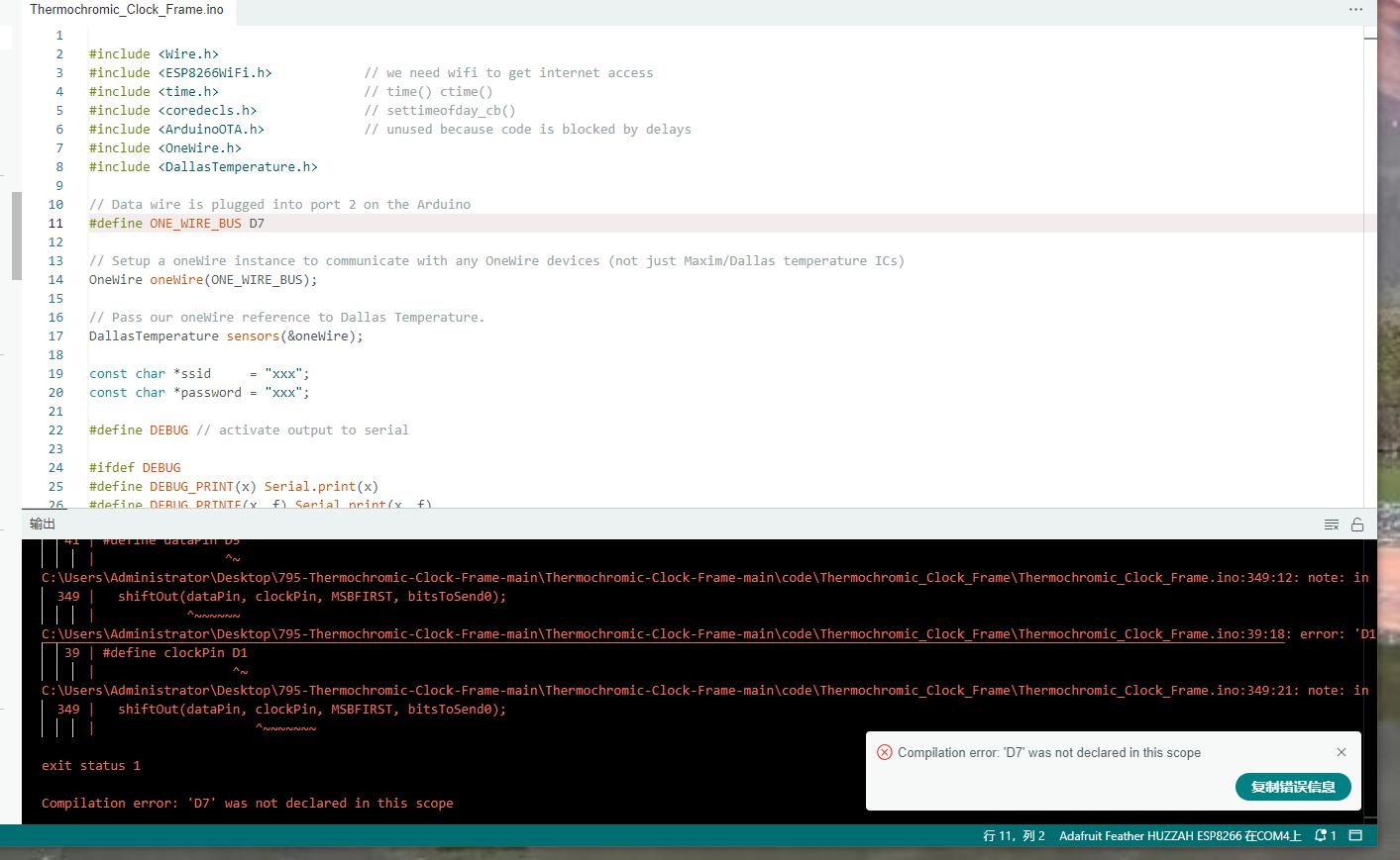

Thank you! Then we encountered a new problem…..
 ![bfa0cecf0a9edb058f74db7814d8afec](https://europe1.discourse-cdn.com/arduino/original/4X/9/c/4/9c4a0280d4237588f6817ab1cd978be854a87e49.png)
