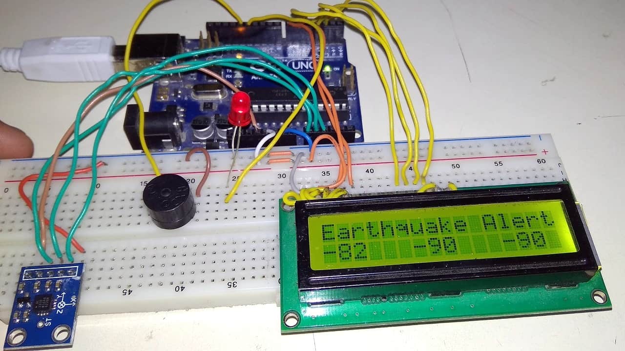

I am making an earthquake detector

I'm going to bet... from here...
You did not copy the code correctly. Here is the original code from the Earthquake Detector (without the Processing code).
