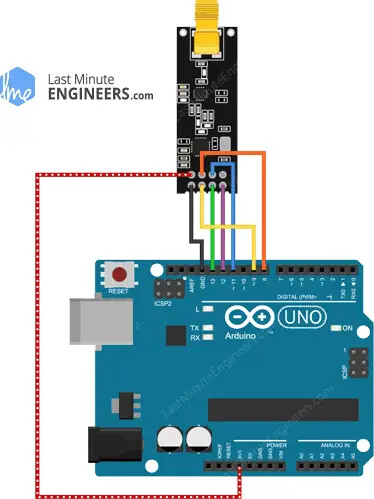

please help me how to resolve this. This is my wiring diagram whenever I press the button on transmitter the message should go though the extender to receiver.

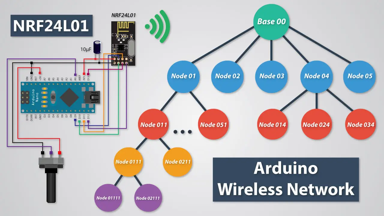

I think these devices can use a star-topology network, so one missing node would only be known if its activity was not received.
This looks like bit complex and my requirement diesnot have base module to talk with multiple nodes.
RF24 communication between multiple devices can be a bit complex, that's why there are libraries built to handle this complexity. Although, really you are just using one address, you need separate addresses to handle 3 devices. See TMRh20s Project Blog for a detailed explanation.
Libraries:
GitHub - Hobietime/RF24G: This library provides a simple way for up to 6 nRF24L01 radios to communicate with each other. - Recently updated to handle up to 7-devices in a mesh style network, need to install from ZIP for latest changes.
GitHub - nRF24/RF24Network: OSI Layer 3 Networking for nRF24L01(+) and nRF52x on Arduino and Raspberry Pi - A bit more complicated to use than RF24G, but works in a similar way, uses a Tree topology.
