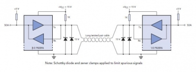

I there, i have test the pull up resistors and nothing happen, please see the picture of the schematic circuit that I've done. I don't know why this doesn't work, I've already pull down the voltage of SDA and SCL to 5V and nothing.

If that diagram is correct then you have fried your Arduino. However I suspect it is not.
I have never come across I2C signals at 12V, does this manual that only you have say that?
If it does then you need a voltage level converter on the lines to get it into the 0 to 5V range the Arduino needs.
There is no need to have a separate voltage regulator the +5V on the arduino will do.
The other thing is that the ground on the 12V supply needs to be connected to the ground on the Arduino. This is not shown on that diagram.
However as I can't see the real data on this device I can only guess at what it is like.
Hi there, finally i got the address of the load cell by using the P82B96 IC (Dual bi-directional bus buffer )
But the load cell only sends to me these values [38 128 255 255] independent of the load charge that i made on the load cell(at least my weight for testing)
It is possible that the values of the load charge possibly are in a different location of memory??
