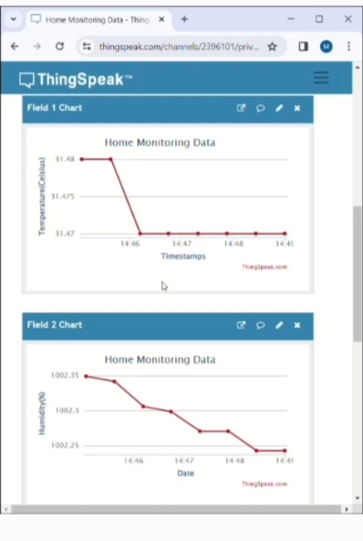

I have been coding Esp32 Devkit V1 & NodeMCU V3 and trying to get data from sensors connected to i²c bus of those two MCU separately. But both cases the sensors are not initializing. But I have tried these sensors on my Arduino uno R3 which worked fine. But When it comes to ESP32 and NodeMCU V3 i²c bus don't work. I have checked with the i²c code and it detects the sensors, but when I upload the original code, it doesn't work.
Here are few steps that I took to make things work
  1. Added 3k ohm external pull-up resistor on SDA and SCL
  2. Changed to default pins like 21, 22 in case of ESP32-Devkit and 4, 5 in case of NodeMCU V3 to other pins, doesn't work!
  3. Checked the wifi connection which works fine and sends -2 lux value to thingspeak. But other two BMP280 & AHT10 sensor doesn't work.
  4. Connected a led to check whether sensors are getting power or not. The led shows the sensors are getting power.

Resistors are 1k ohm each, 3k ohm for SDA and SCL each, for Voltage 3.3v. ...
I will try with external 5V then. I didn't solder yet cause it worked really ok with my Arduino uno r3 so far. But yes soldering is important no doubt, I will do.

After soldering the sensors BMP280 i²c bus
initializing properly, didn't use any resistors! and sending data to the cloud!
