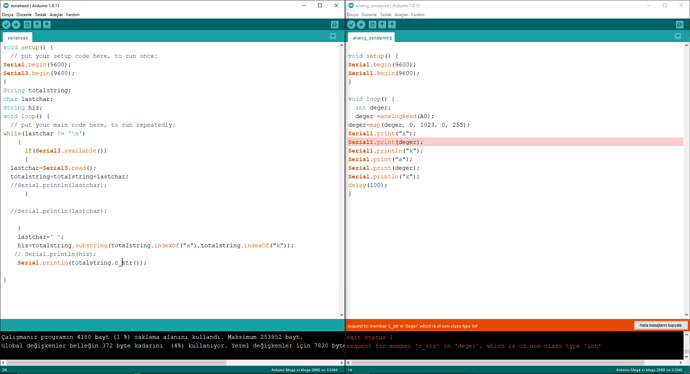

I can print initial sensor value with serial1 but this value doesnt change
Hi, I have a question I try to read sensor value and print this value with serial1. But I cant read with serial3 when read this value with serial monitor also I can read initial sensor value but this value doesnt change on serial3. How can I solve this problem(ignore error message)
// serial3 read code
Serial3.begin(9600);
String totalstring;
char lastchar;
String hiz;
while(lastchar != '\n')
      if(Serial3.available())
  lastchar=Serial3.read();
  totalstring=totalstring+lastchar;
  //Serial.println(lastchar);
    lastchar=' ';
    hiz=totalstring.substring(totalstring.indexOf("a"),totalstring.indexOf("k"));
   // Serial.println(hiz);
    Serial.println(totalstring.c_str());
//serial1 print code
Serial1.begin(9600);
  int deger;
  deger =analogRead(A0);
deger=map(deger, 0, 1023, 0, 255);
Serial1.print("a");
Serial1.print(deger);
Serial1.println("k");
Serial.print("a");
Serial.print(deger);
Serial.println("k");
delay(100);

I can solve.It's because I forgot totalstring set " " bottom of code
totalstring="";
