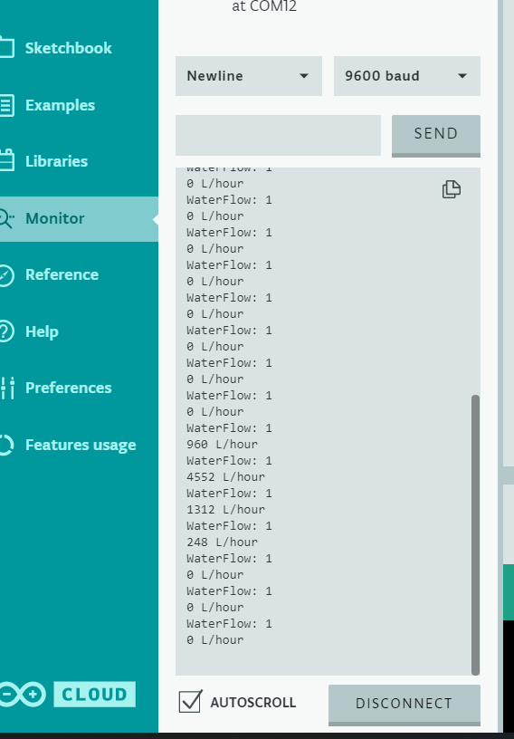

I can't display data on the widget on arduino iot cloud
I am using a waterflow sensor and it shows the data reading in the serial monitor however the wigedt doesn't move
  Sketch generated by the Arduino IoT Cloud Thing "Untitled 2"

#include "thingProperties.h"
#define sensor 2
const byte sensors = 4;
const byte sensorPins[sensors] = {2, 3, 18, 19};
volatile unsigned long flow_frequency[sensors] = {0, 0, 0, 0}; // Measures flow sensor pulsesunsigned
  // Initialize serial and wait for port to open:
  pinMode(sensor, INPUT_PULLUP);
  attachInterrupt(digitalPinToInterrupt(sensor), flow1, RISING);

   onWATERFLOWChange(0);
   waterflow = ENV.read
  Since WATERFLOW is READ_WRITE variable, onWATERFLOWChange() is
  executed every time a new value is received from IoT Cloud.
void onWATERFLOWChange(byte s)  {
  // Add your code here to act upon WATERFLOW change
  static unsigned long l_hour = 0;
  static unsigned long flow_freq = 0;
  noInterrupts();
  flow_freq = flow_frequency[s];
  flow_frequency[s] = 0; // this is used so that the reading of the water flow returns to 0 whenver it stops spinning and not stacking the reading
  interrupts();
  // Pulse frequency (Hz) = 7.5Q, Q is flow rate in L/min.
  l_hour = (flow_freq * 60 / 7.5); // (Pulse frequency x 60 min) / 7.5Q = flowrate in L/hour
  Serial.print("WaterFlow: ");
  Serial.println(s+1);
  Serial.print(l_hour); // Print litres/hour
  Serial.println(" L/hour");
  delay(150);
void flow1() { // interrupt function
  flow_frequency[0]++; // this will increment the  array flow_frequency[s]
