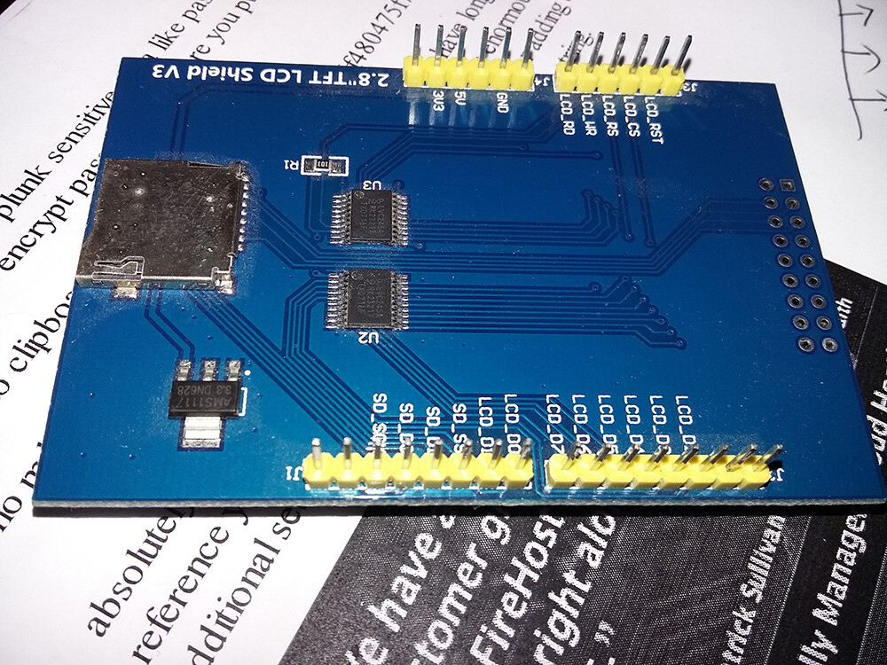

I can't find the library for 2.8" TFT LCD Shield V3, I bought this chinese hardware but I can't seem to find the libraries for it. I only find V2 and it doesn't work. I only see white screen. What's missing?
Go on. Post a link to the actual shield that you have bought.
I bought it offline so there is no link I can attach the pictures of it though.
Please refer to the attached images!
It is a Blue Mcufriend shield.
Install MCUFRIEND_kbv and Adafruit_GFX via the Library Manager.
There are examples. They will tell you the controller ID.

THank you sir.. I can see some activities now.. I found Id, in fact it changed once. do I have to assign that id somewhere in the example code so it works with my one?
All the examples should read the ID. Most report to the Serial Terminal.
Then use the ID to configure correctly.
You do not change anything. However it would be nice if you simply reported the ID in your message.

I got this in serial port
Serial took 0ms to start
ID = 0x8230
graphictest_kbv
I saw "a line" before but after that I'm getting nothing (tried 2 codes all shown same thing). even the same code not showing anything but white screen. Stuck with this screen problem for so long....
:cry:
MCUFRIEND_kbv supports the UC8230 but not by default.

My bad.. I have these arduino libraries in similar location that you gave and your uncommenting edit did work! thank you so much.. I can't believe I didn't look for this forum for help before! May Allah bless you!.
