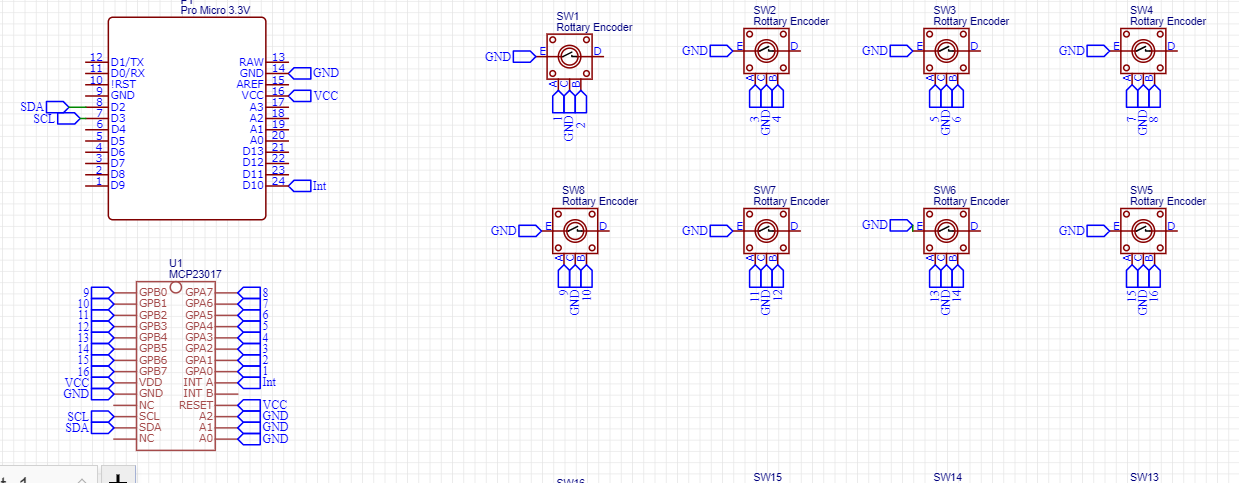

I cant not conect my arduino to mcp23017
hi, sorry for the hypernoob question that im going to do, but, i need some help, i conect the mcp23017 to an arduino pro micro i2c via (2 scl, 3 sda) its really necesary put the resistors into both wires? can someone helpme with a simple conecction esquematic? im really lost XD.

here is my squematic
But that is a Uno, not a arduino pro micro.
So first of all exactly what sort of pro micro do you have?
There are three types of board:-
  1. From Arduino
  2. From Spark Fun
  3. From places like eBay
They all have different pins for the I2C lines.
So please post a picture of what to have.
Yes they are called pull up resistors, and once we know what you have We can show you what to do.
You seem to show a pot connected to two pins going into the MCP23017. That chip handles digital signals only.
Hi, sorry for the late response i was bussy with my job, you are right i have a pro micro (bought from alliexpress actually) and on the image that i shared its an uno, i can explain a bit my idea of proyect, im interested on conect 8 encoders (i2c via) to my arduino pro micro made in china (sda and scl are 2 and 3 pins respectly). i saw this repository tttapa/Control-Surface: Arduino library for creating MIDI controllers and other MIDI devices. (github.com) and i think. its a good idea do that, but, when i put all together dindt work :´( here is my squematic

Pity you did not post a photograph because personally I would not touch that source with a barge pole. You never know what sort of nonsense you will get from them. It probably be not what you think it is.
I urge you to post a photo or the link to what you actually have.
