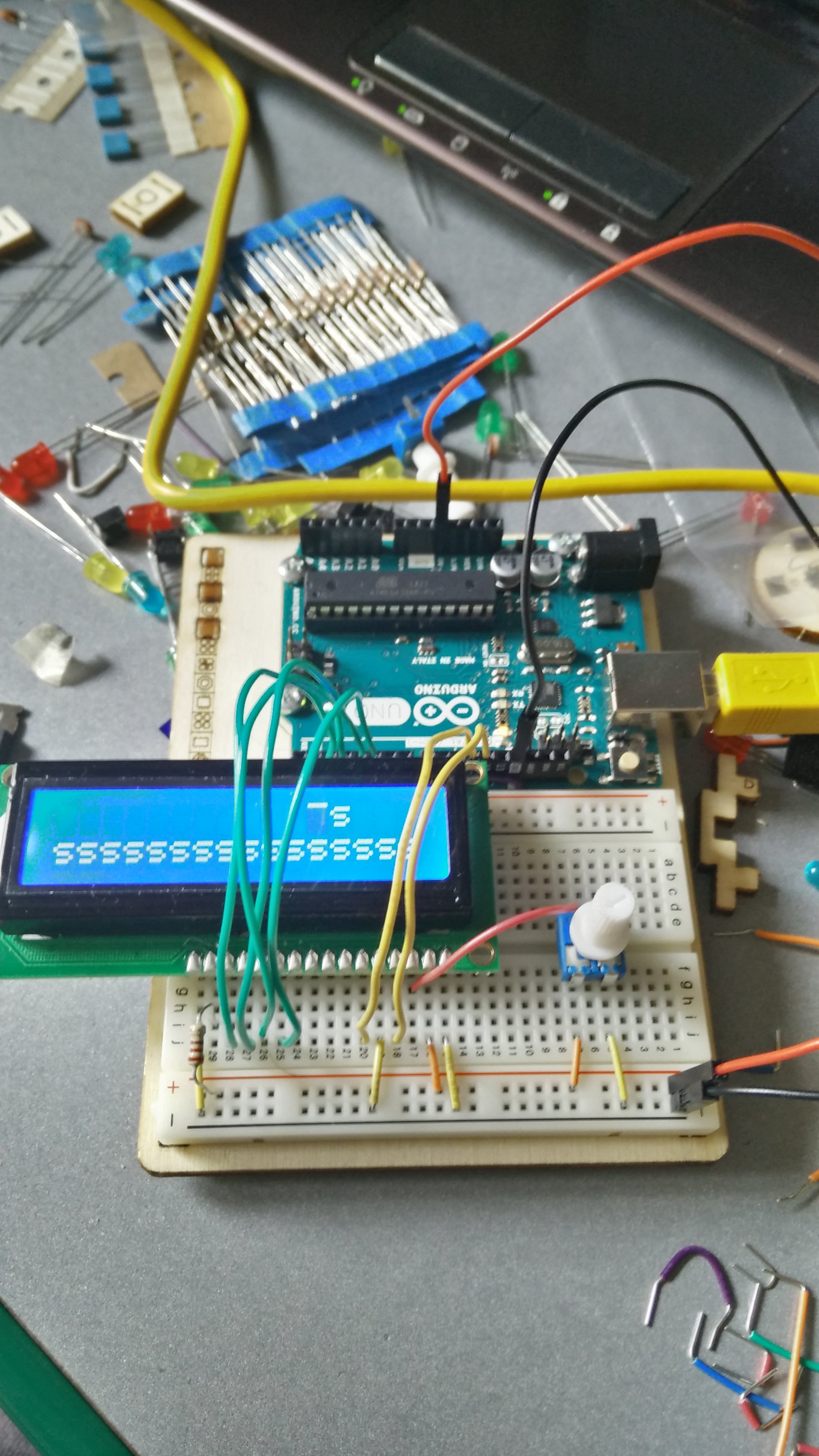

I can't print hello word on my LCD display
Hi, some time ago I bought the Arduino Starter Kit. Today I tryed to use the lcd display with the fritzing's project and the scripts of Arduino IDE but when I try to use the scripts Hello World I receive no output.
There are so many reasons why that might be that no-one here can begin to guess and will not therefore, waste time on it.
If however, you give us a photo of your layout (perfectly focused and sized appropriately for the web page), the code you are using (posted inside "code" tags generated by the little "scroll" icon in the submission area) and tell what the LCD actually does (lights up, shows any pattern at all), some suggestions may emerge.
This is the photo and this is the code:

It's hard to follow your four data lines since the wires are all the same color, but it looks like they are exactly wrong.
Don
I followed this pattern seems to do it.

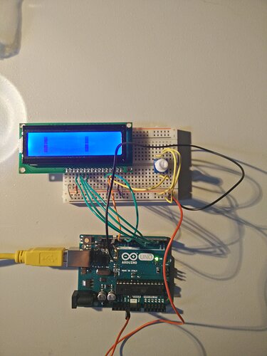

I'm sure you went back and checked after Don mentioned that you made an obvious error but your drawing and your photo show the four data lines are reversed.
Yes, I reassembled it in quickly and I did not noticed the mistake. Anyway today I reassembled it correctly (I think) and I still get no output. I also tryed with another script called setCursor and I received the output in the picture.

... and I still get no output
But you are getting output, it is just not what you expect.
While you are troubleshooting a problem like this you want to use as simple a program as you can and it is a good idea to have all of that code in setup() and have nothing in loop().
Even the sample sketch in the Liquid Crystal tutorial does not meet those criteria. I suggest this one:
#include <LiquidCrystal.h>
//LiquidCrystal lcd(RS, E, D4, D5, D6, D7);
LiquidCrystal lcd(12, 11, 5, 4, 3, 2);      // put your pin numbers here
  lcd.begin(16, 2);                          // put your LCD parameters here
  lcd.print("hello, world!");
  lcd.setCursor(0,1);
  lcd.print("it works!");
Please provide a photograph that is in focus and that lets us unambiguously follow each wire from the Arduino to the LCD module. I think you may have the D5 and D6 wires crossed but it is hard to tell. Can't you find two different color wires for D5 and D7.
Your LCD is upside down.
Don
Yeah, I' inverted the jumper and now it works. I'm sorry for the bother, but this is the first time I use it, and I'm also a little bit an asshole. :cold_sweat:
Congratulations on your success. I don't know why anybody here would think poorly of you - you just seemed a bit frustrated. There's nobody here that hasn't been there and been that.
