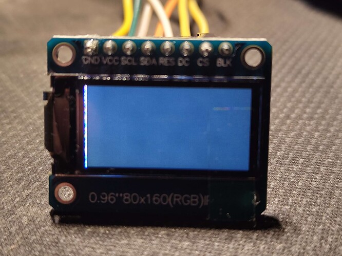

I get a black screen with a colored line at the left of the screen:

Hard to take a clear picture but I've verified that this is the current wiring:
SCL -> GP18
SDA -> GP19
RES -> GP21
DC -> GP20
CS -> GP17
I've also checked the soldering and wires with a multimeter.
I just thinks its so weird that fillScreen BLACK fills the screen with white, and vice versa. But I atleast get some result..
BLK is backlight control pin, right? Nothing seems to change when i connect it to 3.3v.
I tried the same wiring & code setup on my larger 1.44" display and it worked! (The colored pixel line is still present at the side but not a big issue).
Now I just need to figure out why my smaller display is behaving like it does.

UPDATE: I figured it out! I tested another brand new small display of the same sort and it worked . I must've messed up the backlight by connecting the backligt control pin to 3.3v.

Please upload a photo of your screen working, in which you can see that line with multicolored pixels. It seems to me that you only have to adjust a line or two within the library. It is simple to implement. By the way, you can share your working TFT with us.

The line are not an issue anymore, they boot up with a line but after adjusting the knob/volume it disappears.

Got scared when I saw "PWM", but it was as simple as connecting a potentiometer to the BLK pin. All three displays are working now, thanks again for the help!!
