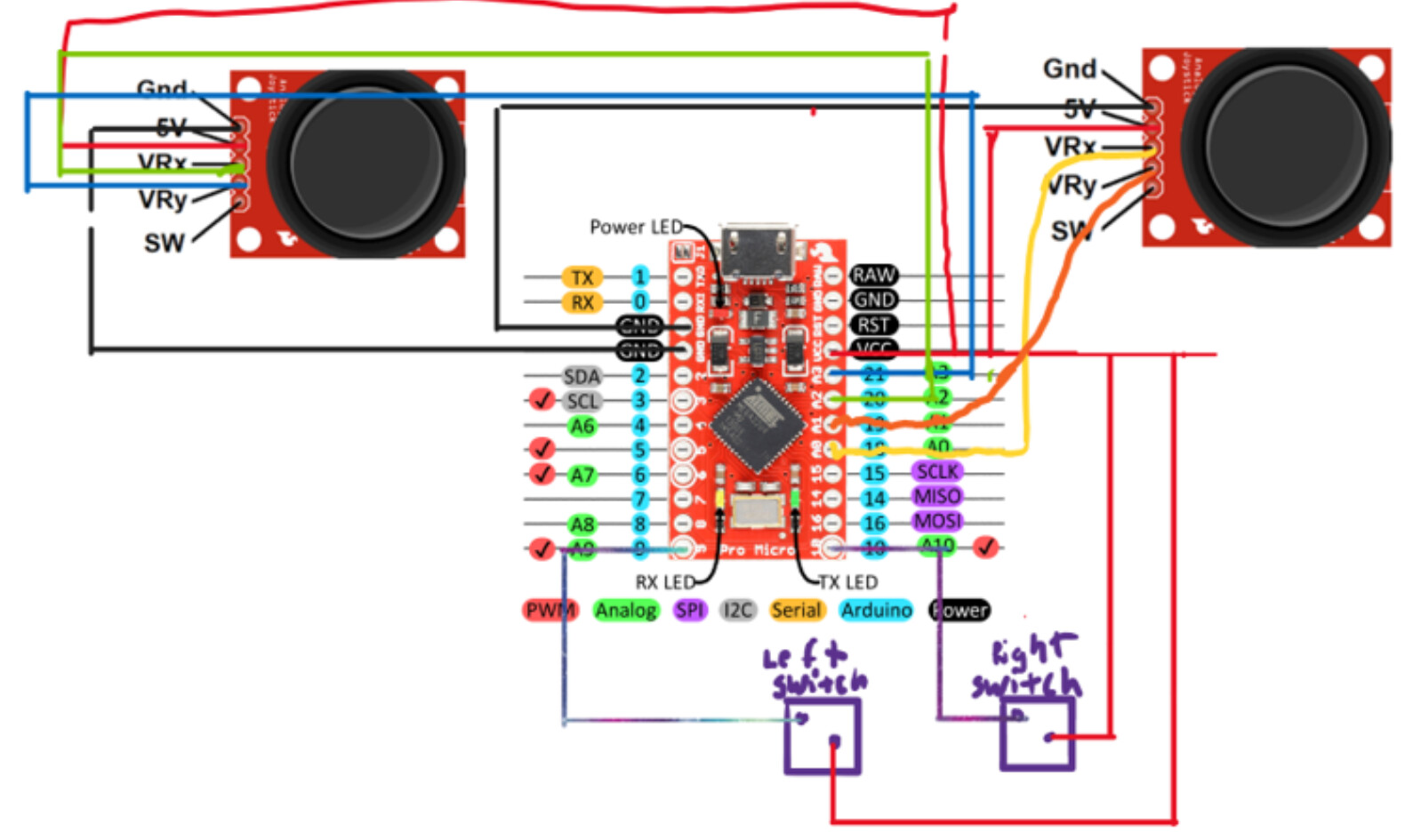

I am currently building an arduino game controller that uses 2 joysticks and 2 cherry mechanical keyboard switches(tactile). I am using both of these 2 switches for the triggers as they feel much nicer than the tactile buttons. However I dunno why but when 'read' from the switches they regularly actuate even if I am not pressing them:

As you can see there is a pattern where it reads 2 values before blanking for 200ms before skipping 2 then re-reading it
When pressed the HIGH is lines up perfectly (HIGH 119,120,121, etc.)
I have tried to change the code a few times to retake the readings after 10ms but I come to the same problem again where it seems to work but then has a specific amount of false readings before returning to normal. I have tried searching up "debouncing" but I am not sure if this is even bouncing?
When I apply their fixes the inputs are either non-existent or it doesn't work
Does someone know what this is caused by and how to fix it?

ok just fixed it, I couldn't add more for a while because a bot blocked, the topic, my first post ;p
Looks like you forgot pull-down resistors.
