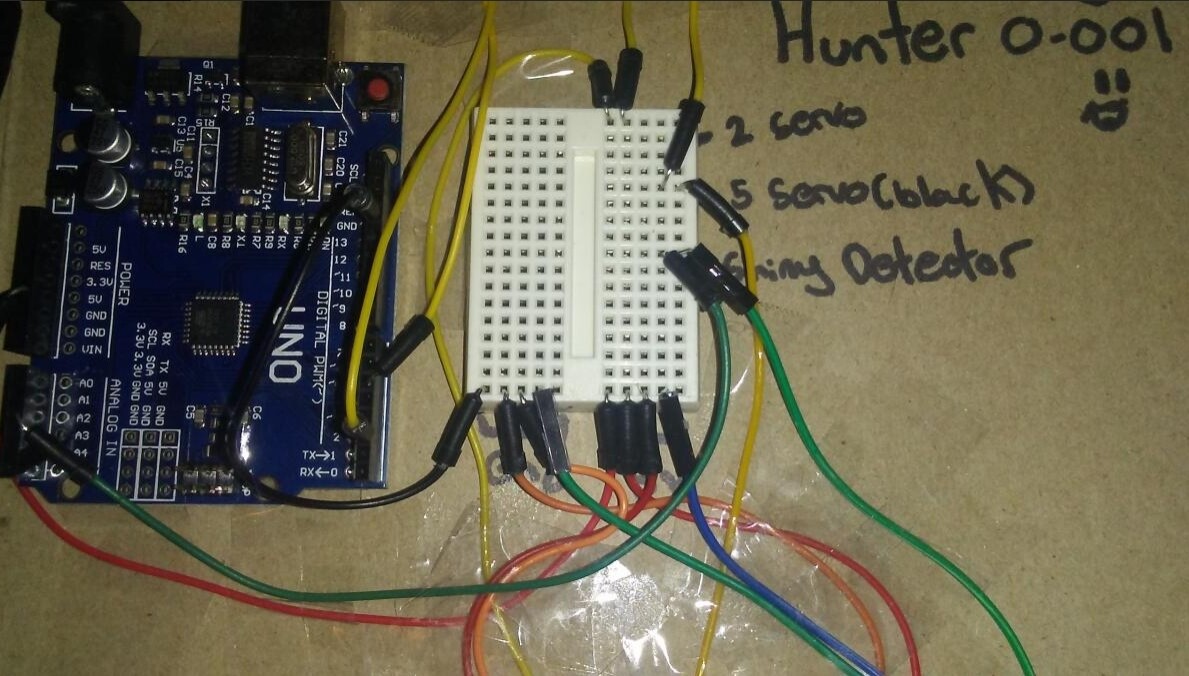

Alright, so I have nothing in the way of code besides:
#include <Servo.h>
But I do have a better picture
The bottom row on the left is GND
The bottom row on the right is 5V
The top two are connecting a servo (doesn’t matter which one) to input 2
The middlish two are connecting the other servo to input 5
the green wired below that are connecting the signal on my KY-018 to A2
My intention is to make this automatically shiny hunt Pokemon as a hobby project.
Draw a schematic showing everything.
Powering two servos with the Arduino is not recommended as you may be drawing too much current.
Do not power ANY servos or motors with Arduino 5V output. You will damage or destroy it.
Use a separate power supply for the servos (like a 4xAA battery pack) and connect the grounds.
