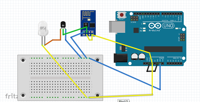

i control my tv with generic esp8266 and the code work correctly but when i start power generic esp8266 it dont connect to wifi when IR led connected to any gpio pin it dont connect to wifi so i disconnect IR led then it connect to wifi then i reconnect IR led i need any help at that problem
Please post your circuit diagram. Some of the ESP8266 pins are used to control how the chip boots up, and your LED might also be drawing too much current.
the IR led work correctly but at fisrt i should disconnect the led until board connected to wifi then i connect led again
that the connection the board dont connect th wifi untill i disconnect the green wire at gpio 2 and when it connect to wifi i reconnect green wire then it work correctly

GPIO2 is one of the pins that the ESP8266 uses to set the boot mode when it starts up. I imagine that having something connected to that is changing the boot mode so the ESP8266 isn't booting like normal.
Also, you need to have a current limiting resistor for the LED, and a resistor for the transistor- is it a MOSFET or BJT?
Also you might need to supply the LED from 5V not 3.3V, the 3.3V regulator on the Arduino can't supply much current.

That Fritzing wiring photo is pretty useless, can you give us a proper schematic? A good picture of a hand drawn picture is fine.

where can i add the resistor plz i search and know the cause of my problem is transistor it draw current and make gpio low and the board cant boot so how can i solve that problem
Series resistor with the LED; base resistor on your transistor.
That still doesn't solve the problem by itself, you also have to switch to high side switching with a PNP transistor.
The 47Ω of R2 is based on 1.5V VF for the IR LED + 0.3V VCE for the PNP = 1.8V total drop, 3.3V supply, giving you 32 mA for the LED.
The 1k of R1 is based on <20x amplification to ensure the transistor is in saturation; at this value it's about 9x amplification. Any value up to 2k2 will do fine here, don't go higher than that or lower than 1k.
As your pin is pulled high at boot, the LED is kept off. Also the PNP can not pull the pin low. Set the pin to LOW to switch on the LED (reverse the logic in your code).
