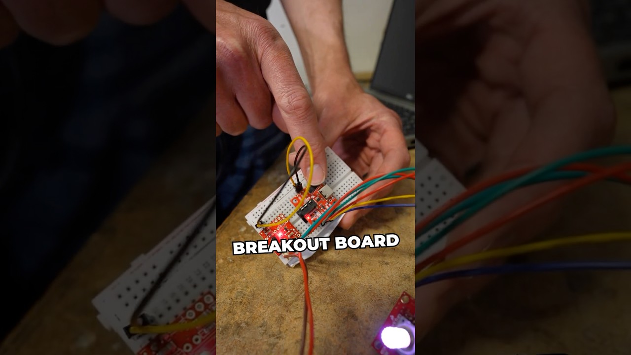

Sparkfun have recently come out with breakout board that looks interesting, it's more expensive than the DFPlayer modules but the video makes it look good. I think I am going to buy one and see what it sounds like.
