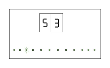

I want to use this as a wall clock
There will be 12 LEDs, not 24.
![Adsız](https://europe1.discourse-cdn.com/arduino/original/4X/b/d/e/bdee6267af6d510b6e0e7e3b2674faffd138a842.jpeg)
it will look like this. At 3:53 the LEDs will look like this.

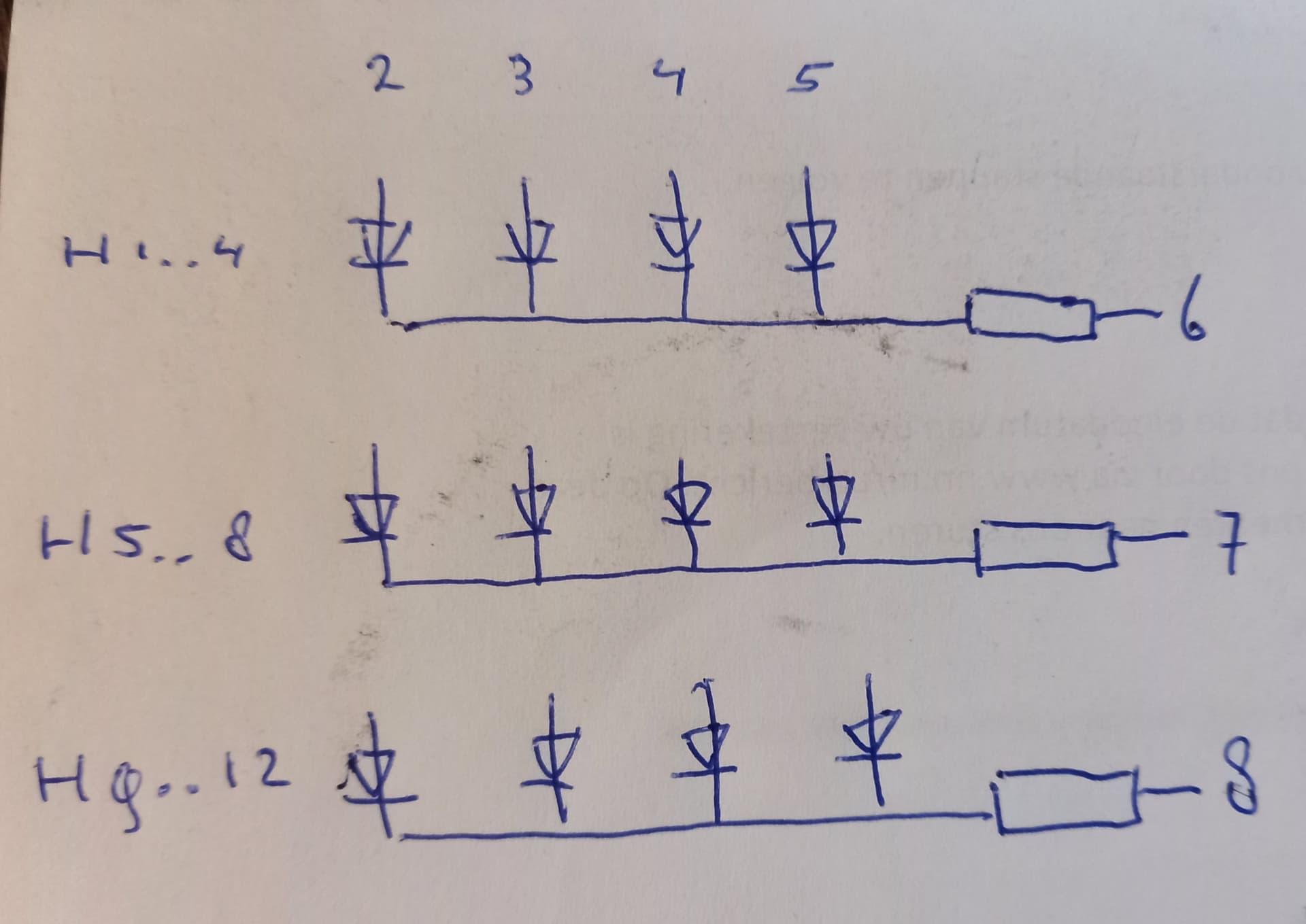

> [@ati\_ati\_ati](#):
> I have 1 Arduino Uno, 1 solderless breadboard, connection cables and resistors.
Do you have the two 7-segment displays? If yes, are they common anode or common cathode?
Start by counting the required pins. I suspect that that is 12 (for the LEDS) plus 16 (or 18 with dots) for the 2 7-segment displays. Your Uno has 20 IO pins but for development you can't use pins 0 and 1 so that leaves 18 pins.
The trick is to use multiplexing. You can control your 12 LEDs with 7 pins as shown below using a matrix. Because only one LED will be on at a time (you will need to guarantee that in software), you can get away with one resistor per block of 4 LEDs. This will not work for the 7-segment displays (you will need a resistor per segment).
 ![20240514_081913](https://europe1.discourse-cdn.com/arduino/original/4X/9/1/a/91a08cd096ded8455a035224ab7e9b31ad3ea753.jpeg)
All LEDs of the first column are connected to pin 2 of the Arduino, the second column to pin 3 of the Arduino etc. So that is 4 pins. For each row of LEDs you use one pin. That makes the total 7.
In software, you can make all pins output using _pinMode()_; pins 6, 7 and 8 need to be made HIGH using _digitalWrite()_. You need to do this in _setup()_. The LEDs will be off.
If you want to indicate an hour, your ALWAYS first set pins 2 to 5 LOW and pins 6 to 8 HIGH using _digitalWrite()_.
Next, if you want to indicate e.g. one o'clock, you make pin 2 HIGH and pin 6 LOW using _digitalWrite()_. Or if you want to indicate 11 o'clock you make pin 4 HIGH and pin 8 LOW.
For your 7-segment display, you use a similar approach. However each segment needs its own resistor. It will require 7 plus 2 pins or, with dots included, 8 plus 2 pins
Be careful
The safe current through an Arduino pin is 20 mA. The safe current through an Arduino port is 100 mA (that is 100 mA for pins 0..7, 100 mA for pins 8..13 and 100 mA for pins A0..A5). The total current through the processor's Vcc/GND is 200 mA.
Notes:
1. A row in the LED design above is a common cathode design.
2. You can also make use of _pinMode()_ (instead of _digitalWrite()_) on pins 6 to 8 to enable a row; in that case there is no need to make the pins HIGH or LOW. _pinMode(somePin, INPUT)_ will disable (switch off) the row, _pinMode(somePin, OUTPUT)_ will enable (switch on) the row.

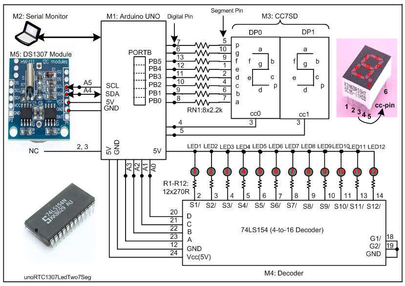

> I have no training in electronics. I'm trying to figure it out by researching, but I need help.
> I need help with coding and connections.
**1.** Check if this dagram (Fig-1) helps you. You have very much shortage of digital pins; so, multiplexing is a logical decision. Other posters may have better proposals.
 ![uartRTcLedTwwo7Seg](https://europe1.discourse-cdn.com/arduino/original/4X/f/8/0/f803431e0ec2fdd946c2889d4e0420b75f85d019.png)
Figure-1:

Before you start the coding, check that the hardware is working. Follow this SSS (Start with Small Step) Methdology that will lead you coming up with a working project.
**(1)** Place only the DP0 display unit on the breadboard. Make connection as per Fig-1. Write codes to show 2 on this display. Do you want codes?
**(2)** Place DP1 disaply unit side-by-side of DP0. You short togeter the identical segment pins (Pin-7 of DP0 with Pin-7 of DP1 and son on... except the cc-pins) to build **multiplexed display unit**. Write codes to show 2 on DP0 and 5 on DP1 simultaneosly. Do you want codes?

**(1)** Place all 12 LEDs on breadboard along with series resistors on the breadbord. Make 5V connection as per Fig-1. Check the healthy conditions of th LEDs by shorting their grounds (just for a while) one-by-one.
**(2)** Place 74LS154 decoder on the breadboard. Connect it with LEDs and UNO as per Fig-1. Write codes to activate the LEDs as per following Truth Table: (Do you want codes?)

**4.** Connect DS1307 RTC Module with UNO as per Fig-1.
Upload the following sketch and check that the Serial Monitor shows the time of the day correctly. (you need to install RTClib.h Library which is ttached with this post.)
