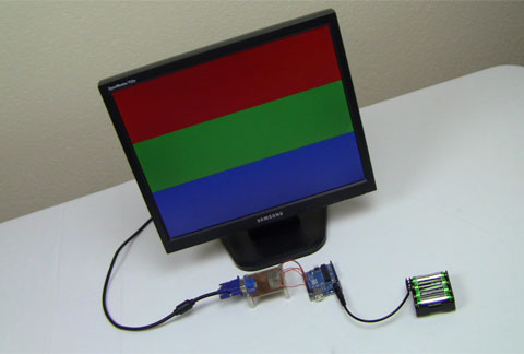

I need help updating old code.
Hey again all, I've been looking around and found an old project that generates an RGB signal, and that would be handy to have something to test monitors that would be quite small, instead of having to hook them up to a pc, and a place where I volunteer often gets many, many monitors and this would save time, plus it's another fun thing I could use an attiny85 for, I would just need to tweak the code to change the pattern every now and then.
So, I was wondering, how do I update this code to work with arduino 1.0.3?
The problem is that I guess arduino no longer uses "# define" anymore, so would I just need to make those variables? I'm going to mess around and try stuff but you guys can probably tell me in 10 minutes.
Anyways, here's the code, sorry it's long but I don't think there are spoilers on these forums.
That is not correct.
What error messages do you get?
Grumpy_Mike:
I get these.
sketch_apr05a.ino: In function 'void loop()':
sketch_apr05a:47: error: 'DDRD' was not declared in this scope
sketch_apr05a:54: error: 'PORTD' was not declared in this scope
if I take out some of the first stuff I get some others later on but maybe they are due to these.
Read the how to use this forum sticky post.
It tells you what include files to change to solve this.
Whoops, forgot to add the library link, that's for reminding me.
http://download.savannah.gnu.org/releases/avr-libc/
I grabbed the very top one.
An attiny85 doesn't have a PORTD, does it?
AWOL:
oh, that's an actual pin, not just a defined variable or whatnot?
The schematic only shows 5 wires, they did it with an uno though and I'm not familiar with it's pins.
Maybe another attiny microcontroller would work if this doesn't, would be a shame though.
Actually yeah, they don't use any special pins from what I can tell, maybe it would work, or there would be a way to make it work.
hmm you know I think I figured it out, the numbers after the part of the code for things like "PORTB" and "PORTD" match up with the pins they are using, maybe I just need to define those pins as those things.
Modified the sketch and defined PORTD and PORTB

Now I try compiling and it highlights VSYNC_LOW and gives these errors.
sketch_apr05a:57: error: lvalue required as left operand of assignment
sketch_apr05a:61: error: lvalue required as left operand of assignment
sketch_apr05a:71: error: lvalue required as left operand of assignment
sketch_apr05a:78: error: lvalue required as left operand of assignment
sketch_apr05a:81: error: lvalue required as left operand of assignment
sketch_apr05a:88: error: lvalue required as left operand of assignment
sketch_apr05a:92: error: lvalue required as left operand of assignment
sketch_apr05a:102: error: lvalue required as left operand of assignment

I'll see if defining vsync or something like that fixes it.
umm, ok I guess I fixed it? I'm not really sure how, but I just deleted stuff I put in and compiled and no errors, I'm gonna run it through notepad++ to compare but here it is.
  VGA
  Author: Chris @ PyroElectro.com
  Description:
  This project is meant to be an example source for anyone
  interested in outputting VGA signal's from a standard
  Arduino UNO development board. The goal is to output VGA
  800x600 @ 60 Hz.
  Full project details:
  http://www.pyroelectro.com/tutorials/arduino_basic_vga/
#include <avr/io.h>

The goal is to output VGA 800x600 @ 60 Hz.
Am I the only one thinking that an implied pixel clock in excess of 30MHz is a tad unrealistic on a microcontroller with a top speed of 20MHz?
If you read the article he has a workaround, sending 200 lines at a time, you don't get full pixel control but you get 3 lines, one of each red, green, and blue and that's all I need to test monitors (although I'll have them switch places).
