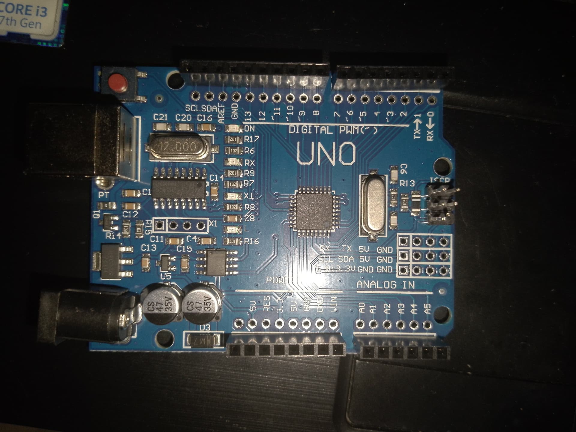

I need help uploading my sketch

My board is a Arduino uno (clone) and im on windows 10 (laptop)
I have a clone Arduino uno
Does windows detect it when you connect the USB cable?
Yes and I already installed ch340
so what about the IDE settings?

That’s frequently either the wrong board specified or a wiring error of some sort. So far I don’t think you’ve told us what board?
Have you now followed the checks advised in post 3 by @xfpd ?

Board is Arduino uno (clone),the only problem is the upload error. And yes I've followed his advise
show us a picture of the board

He has a uno, not a Nano.
