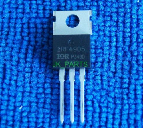

What would a good transistor for running 2 amps at 5 volts? Preferrably rated at a little more than that, just in case. I would also prefer them on ebay, and I need 28, so hopefully not more than a buck a pop. Also, I need them to be NPN transistors.

Must it be a NPN rather then a high current logic level N-channel MOSFET?
By the way those wanting to do high side switching with P-channel MOSFET usually don't find them quite as common as their N-channel brothers, at least with good low Ron specs. Here are some I ordered on E-bay to check out.

5 x New IRF4905 IRF 4905 Power MOSFET 74A 55V TO-220 IR | eBay

Well, I really just need some transistor that when I put +5 (through a 1k) to the Base, it will pass through the ground, or +5 at 2 amps. I don't know much about transistors, which is why I ask for help. The ones you posted look a tad excessive, but if they're good, I'll get em.
Or you can just go to Digi-Key and get a 4A 400V NPN transistor for $0.23 each:

Love you :wink: Do those transistors require a heatsink with them tho? Cause I don't think that will be cheap if it does :confused:

Use power MOSFETs. It's easy to find some that will not even get warm switching 2A at 5V.
Well, due to a day of thinking, I found a way to use less transistors. Thanks for the suggestions anyways guys :slight_smile:
