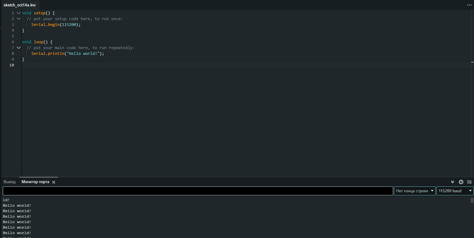

I solved the problem with installing the code in esp32, but now another problem has appeared
when the code is executed it sends me hello world 2 times and then a very large number of strange characters
    Serial.println("Hello world!");
What code would that be ?
here is the code, it should essentially output an infinite "Hello world" value
if I clean the port monitor, it again gives me strange characters
first thing I would do is be sure the serial monitor is set to 115,200
second thing I would try is to throw a delay into the loop to see if the ESP32 is flooding the serial port, overflowing the serial buffer, and getting out of sync
In your duplicate topic (now deleted) the screenshot shows that the Serial monitor is set to 9600 baud but the code sets the baud rate to 115200
you mean like this?
No. The upload speed is not relevant
The baud rate in Serial.begin() must match the Serial monitor baud rate, bottom right of the SM window
Here is the screenshot from your deleted topic showing that they don't match
oh eeeeeeeee
Thank you
it works, I'm 22 years old, and I'm happy like a child
