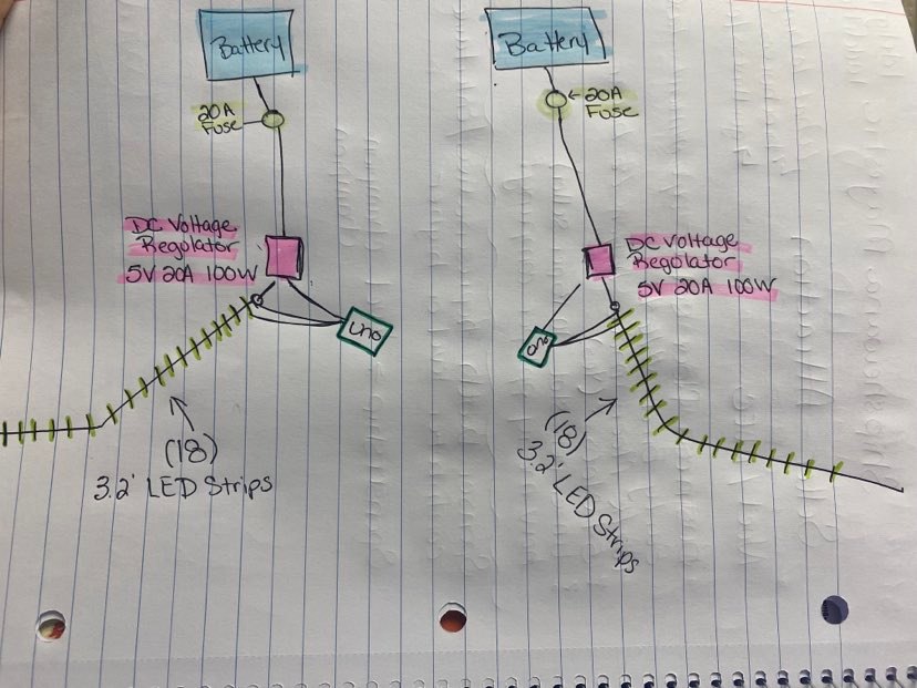

Below is my entire Project- LED & power portion
I was testing on 10 stands with my helper with an AMP clamp, but he said it wasn’t pulling correctly for some reason and I didn’t quite understand why.
But I have a total of 18- 3.2’ strips per side. (See my not so good drawing)

Question- how many LED’s can I put to one pin? I’m sorry, I’m not understanding the math you are getting.
I feel like this is a lot of information and questions but please let me know if I can provide anything else to better help. I appreciate everyone’s help!
Well it is not the way it is normally done.
Using the power of a thing can be misleading. As you know the power is calculated by multiplying the voltage by the current. That is fine when talking about a light bulb in normal circumstances but is confusing when considering designs in electronics. When we design something we always work with voltage and current. The power is only useful to make comparisons with other lights.
So in post #10 that data sheet should be interpreted as you needing, as it says 0.1 W/ LED, which is somewhat of a useless figure. It shows that you need 5V, so considering any other voltage, like 12V is useless because you can't use this voltage, it has to be 5V. So lets convert that into current.
Using W = E x I
Where W is the power in Watts, E is the voltage in volts and I is the current in amps we need to rearrange the formulae to make I the subject of the equation, this gives:-
I = W / E
and plugging the values into that we get
I = 0.1 / 5 = 0.02 Amps or 20 mA which is exactly the figure I used in my calculations.
So for each LED colour you need 0.02 Amps so for full colour (all three colours) you need 0.06 Amps.
It is then a simple matter of multiplying this figure for the number of LEDs you have it total. As I showed before and it comes to a big number.
So how to reduce this? There are a few ways to do this but it is a matter of trading off brightness and or number of colours to be on simultaneously.
For a start there is an overhead current of 1mA for each LED you have irrespective if it is on or off, something not mentioned in the data sheet but something we know here following members experiments. This is for powering the controller chips embedded in each LED.
Each LED can have a brightness level set by the software, and many driver libraries have an overall brightness level settable in software. Some use the numbers 0 to 255 others use percentage levels 0 to 100. If you set these then the software makes sure you can't exceed these levels. So setting these levels to say half the maximum will half the maximum current your strip will need in terms of current. This of course will not be as bright, but the logarithmic response of the eye means that lower brightness levels look brighter that you would think.
Limiting the number of colours will work as well, but it is quite easy for you to make a mistake with the software and have more than the number of colours you want on at any one time, so I would not recommend that way of limiting the current.
An other way of reducing the current is to reduce the voltage, so instead of using 5V you can use a lower voltage, down to about 3.3V (or 3V3 as it is normal to write). However, you have to limit the voltage fro the Arduino to the same voltage level as you are driving the LED strip from.
Incidentally you should have a 510R resistor in series with each data input to each strip to help suppress reflections from the line of data. This could help with your original problem, as could powering the strip from both ends.
It is also good practice to put a large capacitor on the power supply pins of each strip to help smooth out the current surges during the PWM used by the LED controller to vary the brightness.
Hope that clears some things up.
