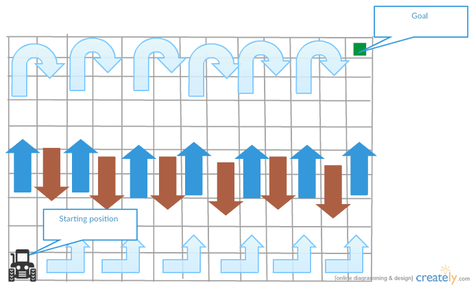

am having an issue with my grad project, am tasked with making a robot that moves in a square wave pattern like the first picture below in attachments ,while applying obstacle avoidance as well .
and in order to know how much distance did the little guy go i used IR encoders by counting the number of clicks the robot makes while moving and using that number in the following formula to get the distance

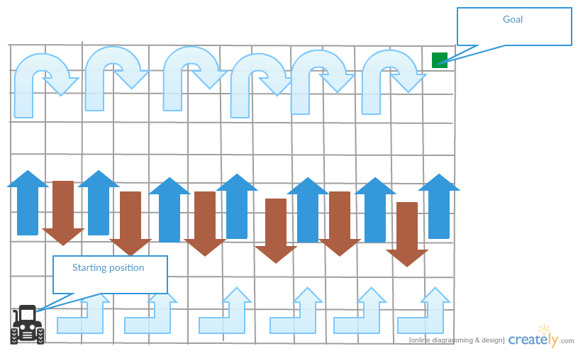

Excellent. And I can show off my vocabulary now, because that "square wave pattern like the first picture below"
has a name, boustrophedon, from the (ancient) Greek for 'like the ox turns' - as in ploughing a field.

Hi Mark! What picture is that? !!! You better share the picture. I will be googling that word you mentioned. Got me interested already.
Also, did you post this message under the wrong thread?
(or case of a spambot/wormbot takeover of account? heheheheh)
I think he means this one.
Oh I see! Ok..... that's the modern form. In the old days, it used to be ox plough. But now it is tractor ploughing.
The only thing here is, assuming that a tractor knows how to write words in the ground ....... standard boustrophedon will have some kind of behaviour ---- such that when the tractor starts coming around to begin its right-to-left journey....... the tractor's writing needs to be flipped 180 degrees for the 'right-to-left' journey. This is assuming that the tractor was going left-to-right on the first line (leg) of the trip.
So it would sort of be similar to writing words in "cascade" format (ie. all joined along one line), except, when we curve the line around (to get to the next line), the line will need to be physically 'twisted' 180 degrees (ie. a 180 degree "axial twist" for each alternate line).
