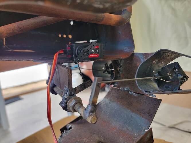

Do you have this mechanical part working by itself? Until you do there is no sense continuing. You will need it for testing all the subsequent processes.
I'm not quite there with the sculpture yet. I haven't worked on the mechanism, I do some welding everyday and some work on the code as well. I don't see the mechanism being too complicate... compares to scissors and will be using a 13kg servo (Power HD, LF-13MG).
Test as you develop.
Then I shall work on the mechanism today. the eye opening is there. I have to make eyelids on pivots with a rod attached to the servo.
I will probably build mechanism and make a wooden rack to mount it on to test as the bust I am working on is quite large (16 inches high at the time).
Do you mean they aren't doing what the code says, or that you haven't expressed correctly yet the thing you want them to do?
If they aren't following the code, you may have a power supply issue which woukd make us wonder about how you are ensuring adequate power delivery to the variuous parts of your device.
a7
So today I built my eyelid mechanism... I need couple M3 bolts. will need to go Ottawa tomorrow to grab some. Once I get the screws some nuts and washers, I will be able to put them in place and find the travel distance i need on the servo.
May I suggest shoulder bolts. you do not want to use threads as bearings.
It needs to be M3 so I could only find screws online at fastenal with double nuts and double washers for under 5$.
There is a local fastenal where I am going tomorrow and can easily pick them up.
Ask to look at their shoulder bolt selection. You seem to be building stuff like an old farmer would build.

I googled a bit this morning and found some M3 4mm shoulder bolts but price is out of my budget for now. If the normal M3 bolts causes issues because of thread then I will upgrade at a later date.
Looking forward to seeing some pics of the completed project.
I have completed the mechanism and servo is attached to it with sweep code and it works like a charm. the eyes simultaneously shut and open.
