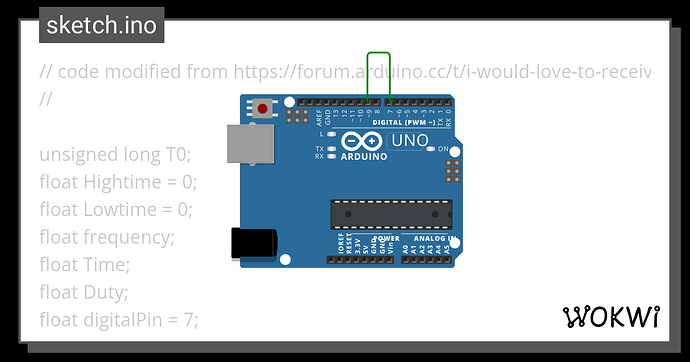

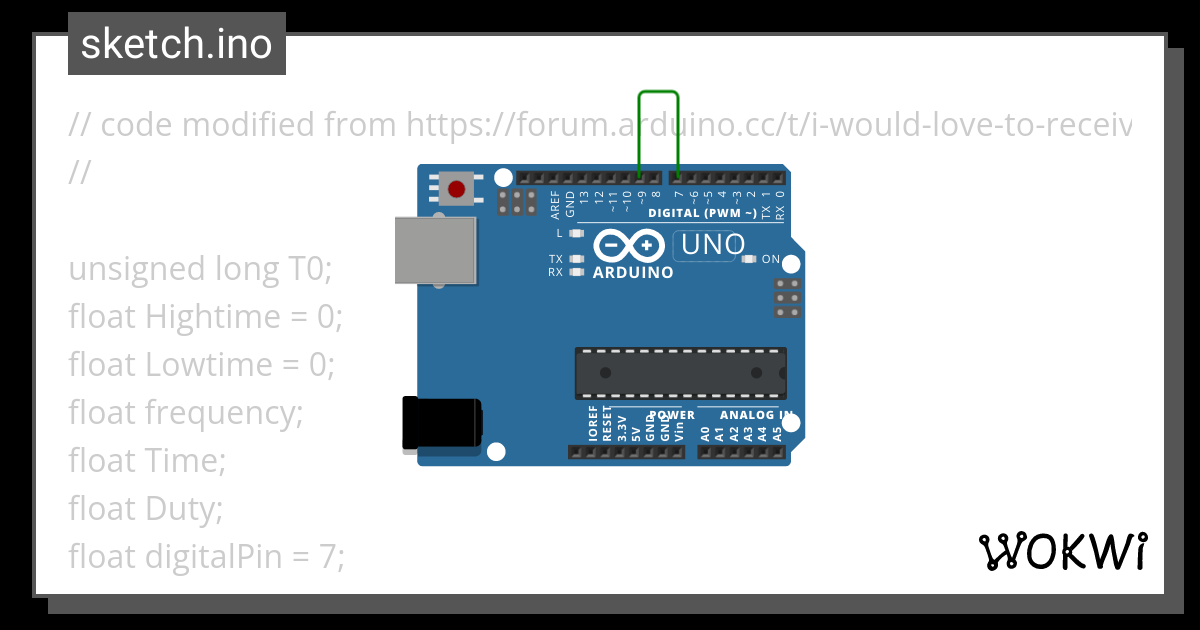

Your detector does not need to re-calculate interim Hightime until the HIGH actually finishes. This would do it cleaner:
    while ( digitalRead(digitalPin) == HIGH); // wait to fall
    Hightime = micros() - T0; //measure the high time;
I cleaned up a few things in your code to streamline the edge-detection polling and added using the TimerOne library to simulate a transmission:
// code modified from https://forum.arduino.cc/t/i-would-love-to-receive-help-with-frequency-transmission-using-arduino/1211551/29?u=davex
// https://wokwi.com/projects/387127367989449729
unsigned long T0;
float Hightime = 0;
float Lowtime = 0;
float frequency;
float Time;
float Duty;
float digitalPin = 7;
const byte simPin = 9;
#include <TimerOne.h>
  pinMode(digitalPin, INPUT);
  pinMode(9, OUTPUT);
  Timer1.initialize(250);  // 250 us = 4 kHz
  //analogWrite(simPin, 10);
  Timer1.pwm(simPin, 500);
  bool read = digitalRead(digitalPin);
  for (int simDuty = 1023 / 10; simDuty < 1023; simDuty += 1023 / 5) {
    while (digitalRead(digitalPin) == LOW); // wait to start
    T0 =  micros(); // mark the first rising
    while ( digitalRead(digitalPin) == LOW);
    Time = micros() - T0; // measure the total time
    frequency = 1000000 / Time ;
    Duty = Hightime / Time;
    Serial.print("Tus:");
    Serial.print(Time);
    Serial.print(" f:");
    Serial.print(frequency);
    Serial.print(" HighUs:");
    Serial.print(Hightime);
    Serial.print(" d:");
    Serial.println(Duty, 3);
    Timer1.pwm(simPin, simDuty); // change the duty cycle sim
    delay(777); // pause for viewing
    while (digitalRead(digitalPin) == HIGH); // wait again

By the way, is there a reason why the code won't work on the mega 2560? It works fine on uno but on mega it doesn't run
Timer one only works on timer 1 pins , which differ from device to device. There’s a table in the docs that says which pins work:
https://www.pjrc.com/teensy/td_libs_TimerOne.html
