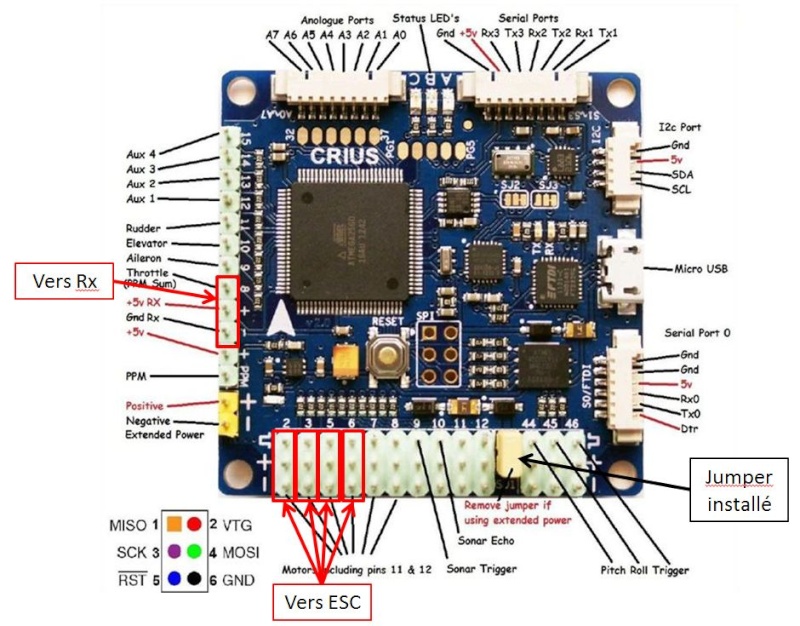

The Crius seems to have 4 COM ports. How many do you need?

- Um, I'm not really sure. How can you tell there are 4COM ports?
Your picture, in your original post, shows Serial 0 on the right side, at the top, and Serial Ports 1, 2, and 3 at the top. Even with shoes on, I can count to 4.

And then A0(Crius) is connected to A4(Arduino) And A1(Crius) is connected to A5(Arduino).
Why? While A4 and A5 on the Arduino are the I2C pins, nothing in your picture suggests that A0 and A1 on the Crius are its I2C pins. In fact, the I2C pins appear to be at the lower, right in your picture, not along the top where the analog pins are.

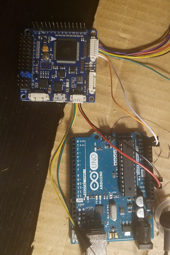

Here's a visual pic of my connection..
A useful picture would show both ends of all wires.
Your two pictures don't even show the same board.
If the unlabeled connector, with the 4 wires, in the lower, right corner of your board, is the I2C connector, then the yellow and green wires are supposed to be connected to the A4 and A5 pins of the Arduino. You appear to have those pins connected to TXD and DTR on the Crius. That's not even close to right.
